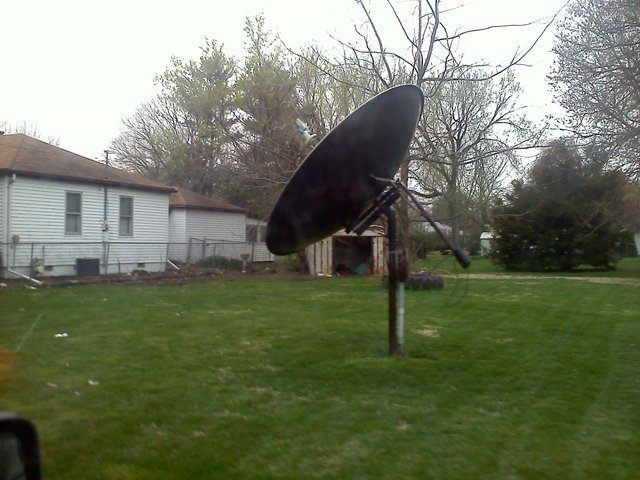

Found this dish driving around. Ugly, but its aluminum and will paint up nicely. Got it for $25, which is scrap price. The next closest was 75 miles away, sure beats driving that far.

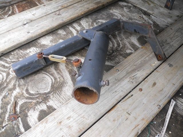

Can anyone ID it? Oddball looking. Uses a turnbuckle to adjust elevation.
Looks like a spun aluminum, but who made it? Don't know. Mine uses a turnbuckle. It's not oddball.

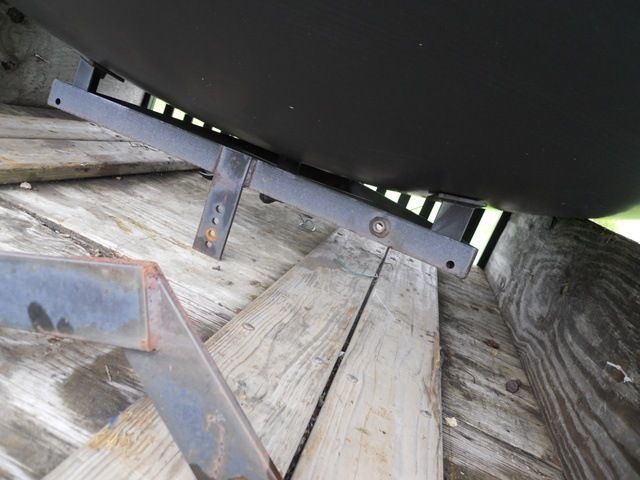

Going to be getting it tomorrow hopefully. Was not able to get it tonight due to bad weather. The mount attaches to the reflector at 3 points like a triangle. I did not see any kind of label or brand on it. Anyone know?

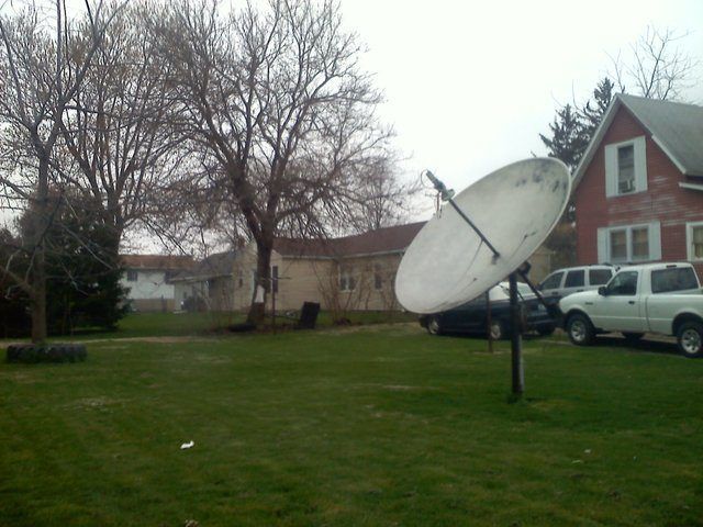

Only 4 miles away. Here are some more pics. Dish is 7.5' might be able to do a little S2 with it. It is spun aluminum, would if be safe to sit in to paint it?

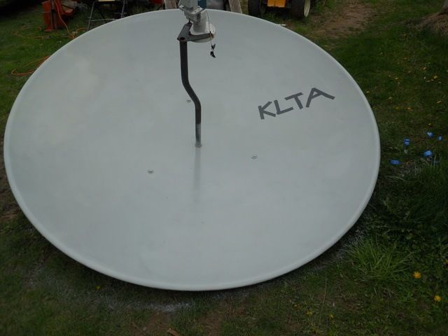

Well I got half of it painted, I'm going to switch to spray paint, brushing it on is taking forever. It is not the heaviest made dish, lift one end up and it bows. However I did lay inside of it so my weight was distributed evenly and it did not harm it. It was bare aluminum at one time, and someone painted it before. It's looking much nicer.

As you can see the reflector attaches to the dish in a triangular fashion. The dish is spun aluminum.Not spun very well because there are thick groves visible in the dish. Also the aluminum is rather thin, and if you pick up on one end, it is wobbly.
The LNB is a 60 degree cal amp. I'm dating this dish to be late 80s if the lnb has not been replaced.
The motor is a FASCO actuator.
The elevation adjustment is a stainless steel turnbuckle, one of the only stainless parts on this dish. The declination adjustment is 4 holes, just put the bolt in another hole for declination adjustments.
There is no nameplate or name anywhere on this dish, so maybe you guys can help ID it.
