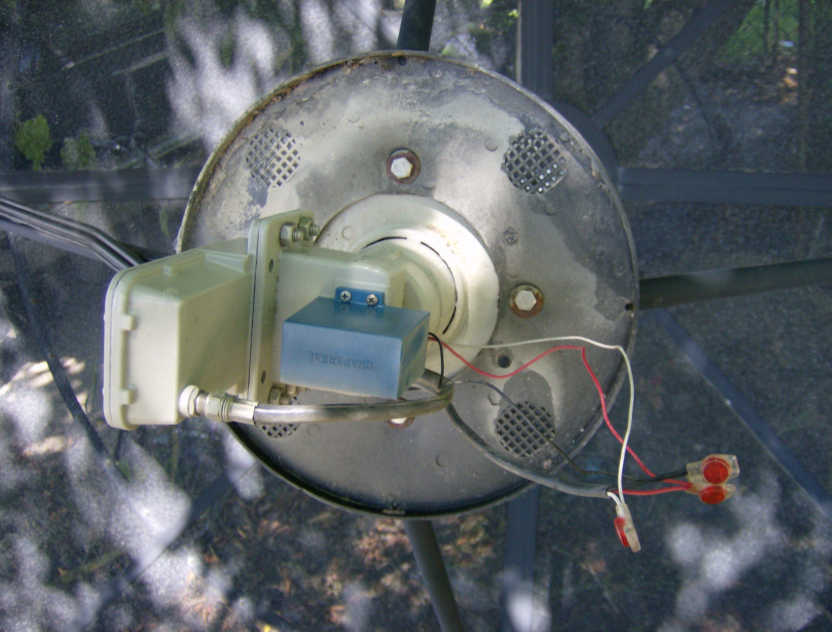

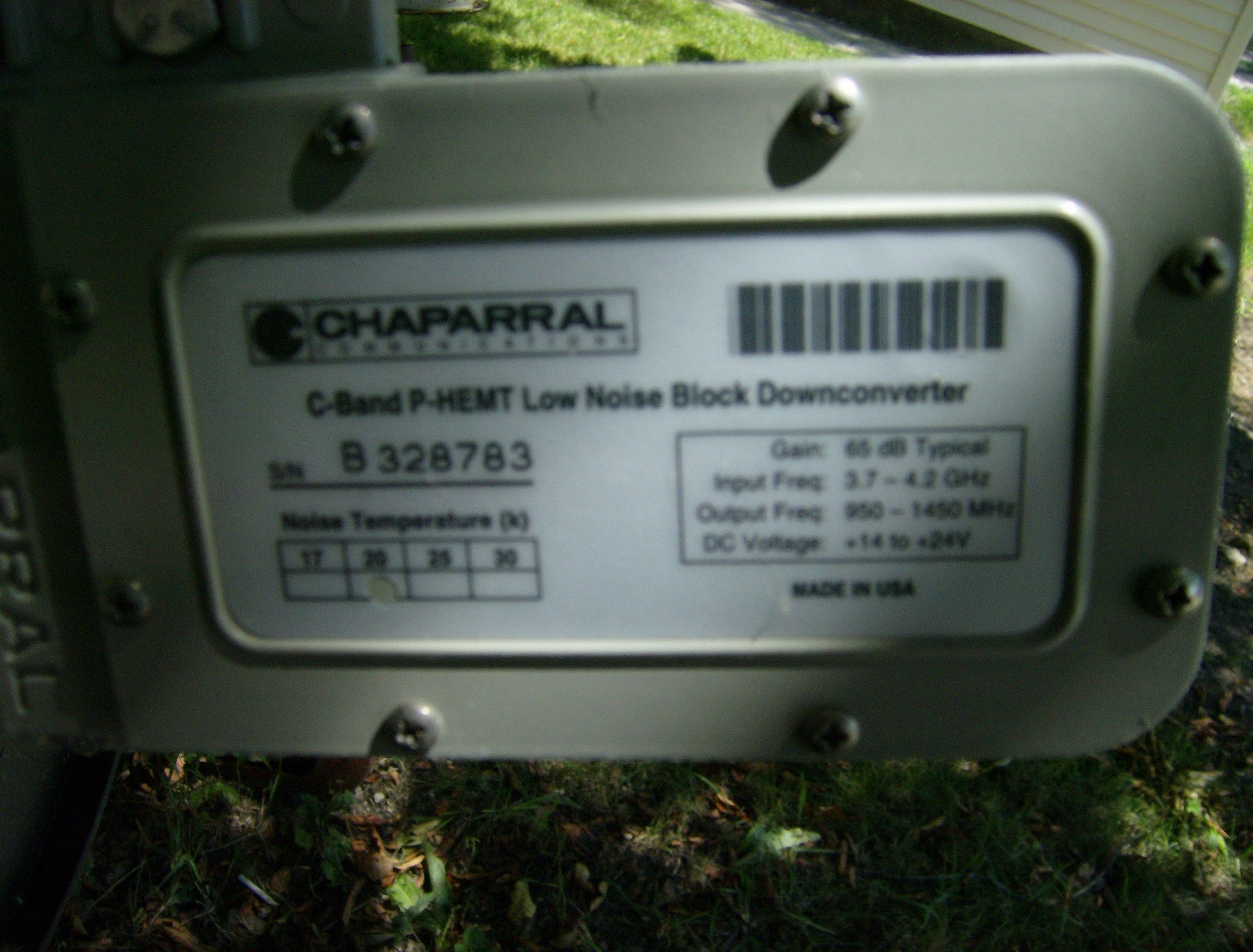

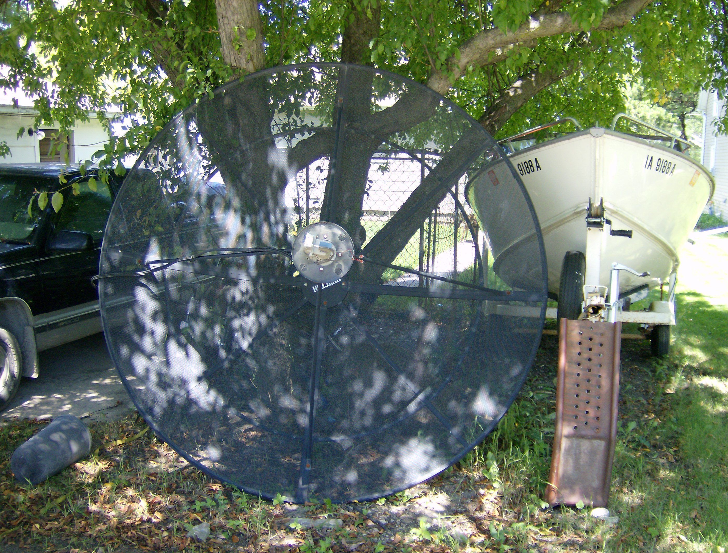

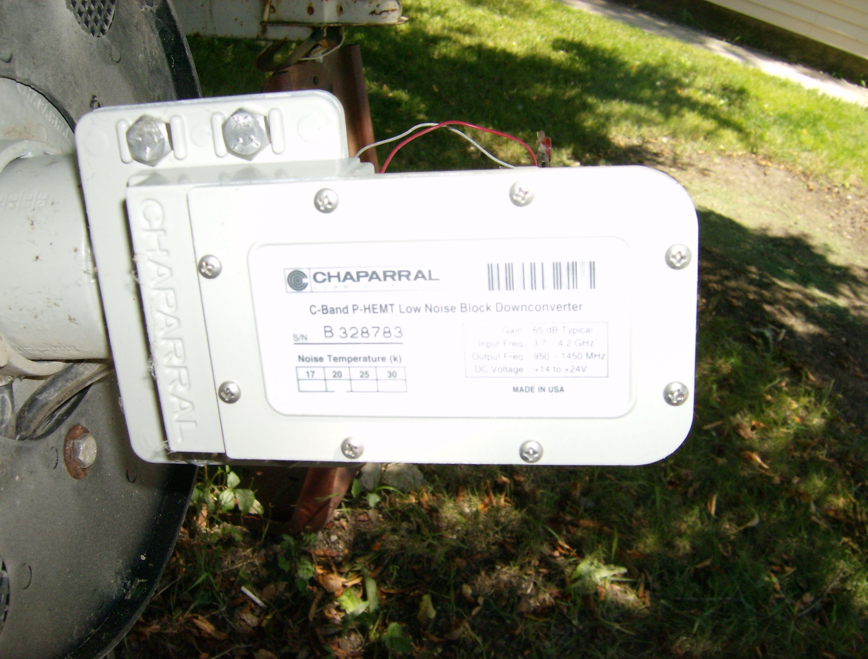

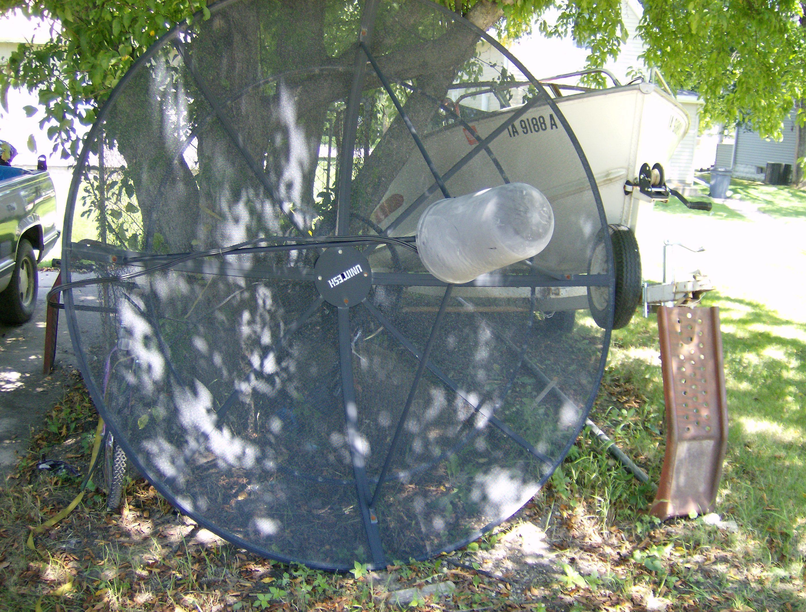

I got my first BUD today and would like to know if & what I would need to use the lnb that came on the dish.

I have the same dish with H-H mount and HTS Tracker 70 receiver for moving the dish and operate the servo for polarity control for the Chaparral Corotor II Plus Wideband Feedhorn.
Hi Boxxman, you could start using the LNB as is simply by taking a pair of needle nose pliers and wrapping the tips with tape and gently move the probe inside the feedhorn to either vertical or horizontal polarity. Makes for a good test of the LNB and if it is still good you would be able to get half of the TPs.
BTW - the old LNB (provided it is still good) will work great on HD, I can even receive the DVB-S2 stuff and I have the same LNB.
Hope this helps, DC
