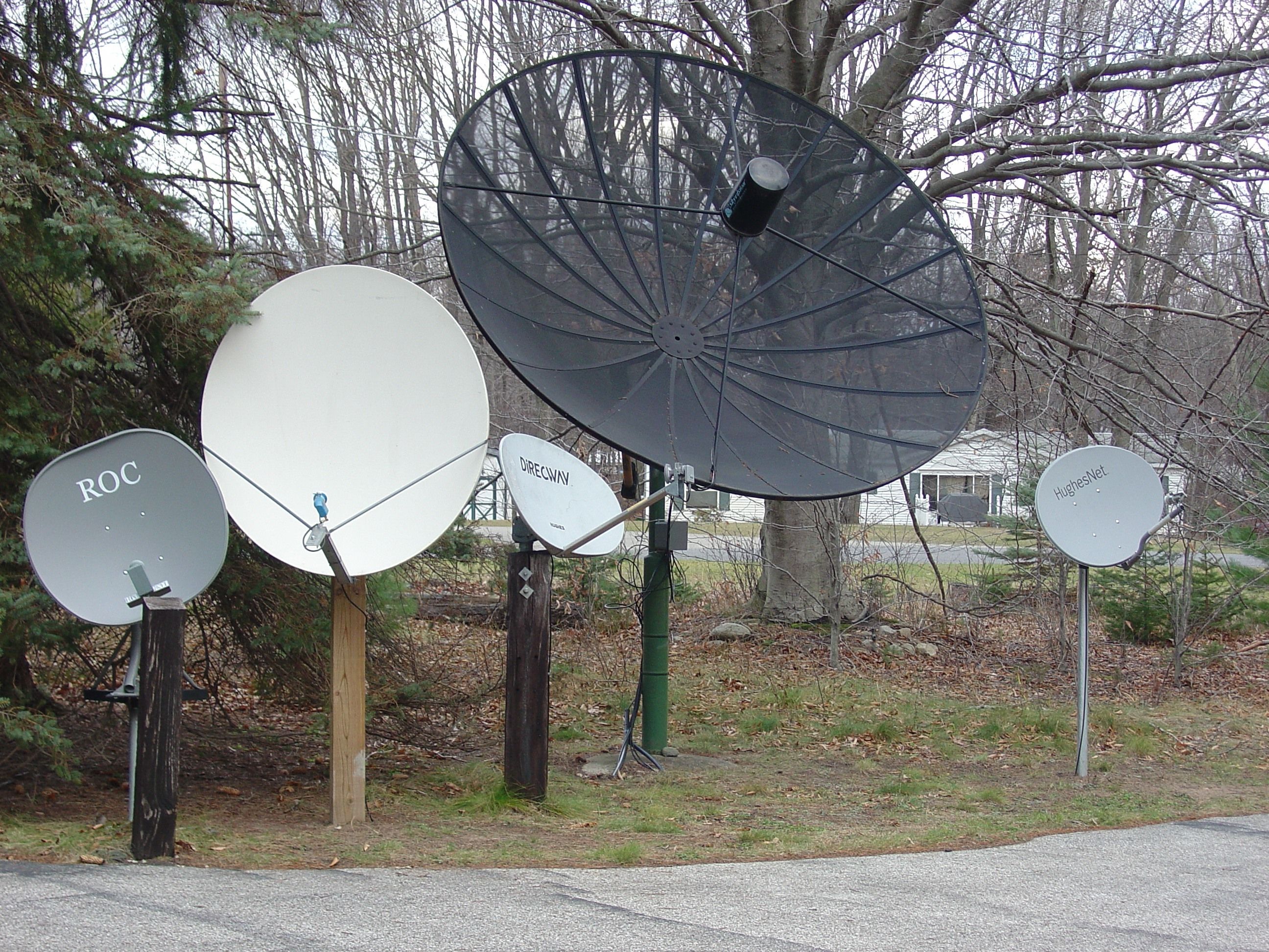

Yes, as Ice has stated.
You can see with my ROC on the far left the LNB is "square" with the dish and the "tilt", skew, was done with the dish rotating.
