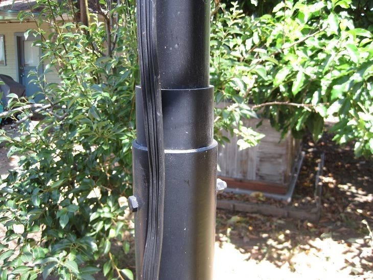

Got a pole delivered for the BUD

Are you sure about that Mike? I have never had a steel supplier refer to inside diameter on any of the pipe that I have ever purchased. Maybe specs are different here in Canada.
And its too wide. F***!

The pole that I am getting has a 4.5 inch outside diameter. The guy that I am buying it from is going to weld a smaller diameter piece 8 inches long on. I'm taking the flange with me when I go to pick it up. :)
What size did you order and what did you end up getting?

My oddball "half-horizon" mount used a 4.5" OD pipe. When that unit went bad and I replaced it with a 3.5"-OD mount and dish, I bought two smaller sections of pipe and telescoped them together, with a couple of big Grade-8 nuts and bolts. It has worked fine for several years. Kraven, you could probably do the same thing.

Anywho, he pipe came from a relative....she didn't fit the WSI polar mount. Looks like I'll pick up a 2.5" pipe from Lowes or somewhere else. The irony is the pipe will cost more than what the dish is worth.
Besides that its hard to find a 6, 7.5 or 8ft BUD in these parts. WSI's dish was inexpensive that I didn't mind swallowing the UPS costs. Then i found out what a marvelous piece of engineering it was.
Cheers, K
Wait!
Is this another case of too little info, and too many assumptions?
What size IS your pipe?
And if you're complaining it didn't fit a 6' WSI dish, that's a whole 'bother matter.
The WSI uses a non-standard post size.
Dude... Ive been ranting about this WSI dish for over a year...
The pole was either 2 3/4 or 3".
Cheers, K
