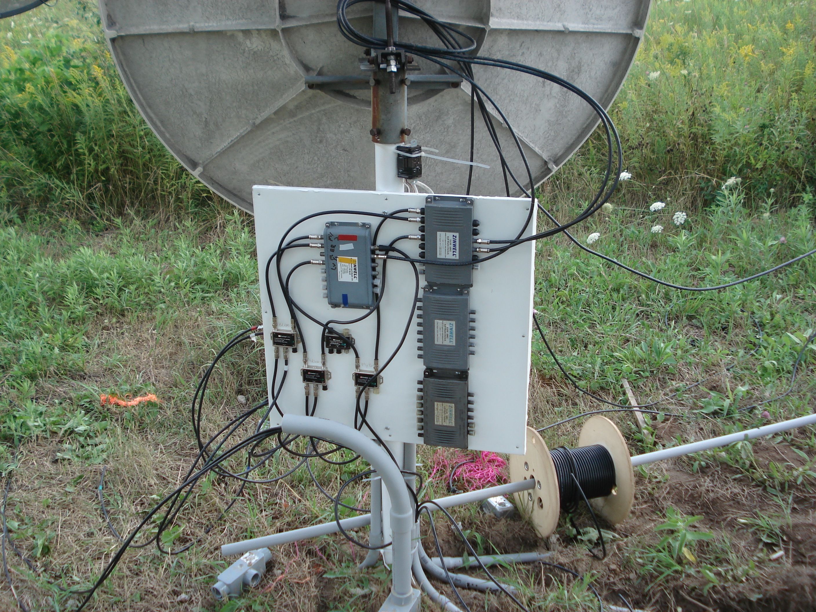

I did not realize that the universal had built in 22khz. that throws a wrench to my setup. I do understand that the zinwell has only 4 usable ports. Ive been using a zinwell 6x8 for a few years already. I just got 4 more of them used at a good price. During the dish farm move I ran 110vac out there also just in case I have to go to powered switches in the future. I made a 2" x 2" board up at the closest pole and mounted all the 1 x4 diseqc and zinwells at. Have most of them wired but have to bury a few more runs to the dishes. I was in hope of using the dual universal. I guess I will have to order one more dual linear standard than I thought. I have a funeral to go to today and then to work so wont be getting much done on it yet today. Will get back when get back to work on it. thanks for the help.

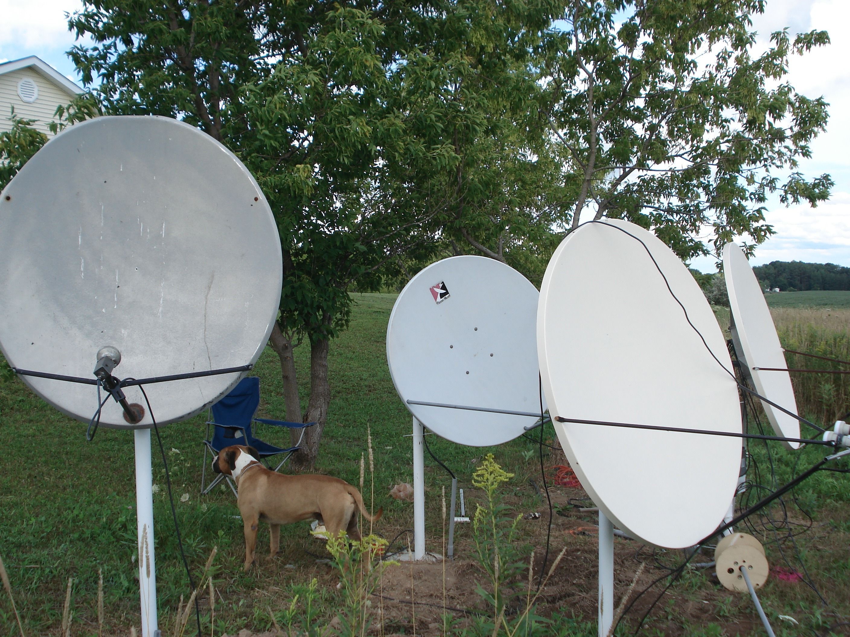

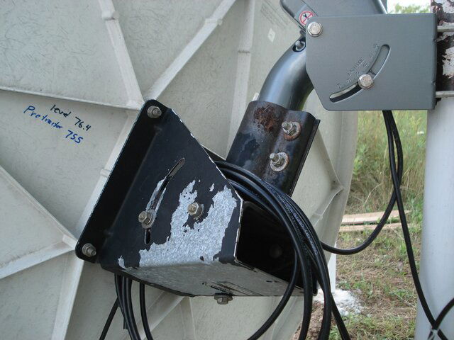

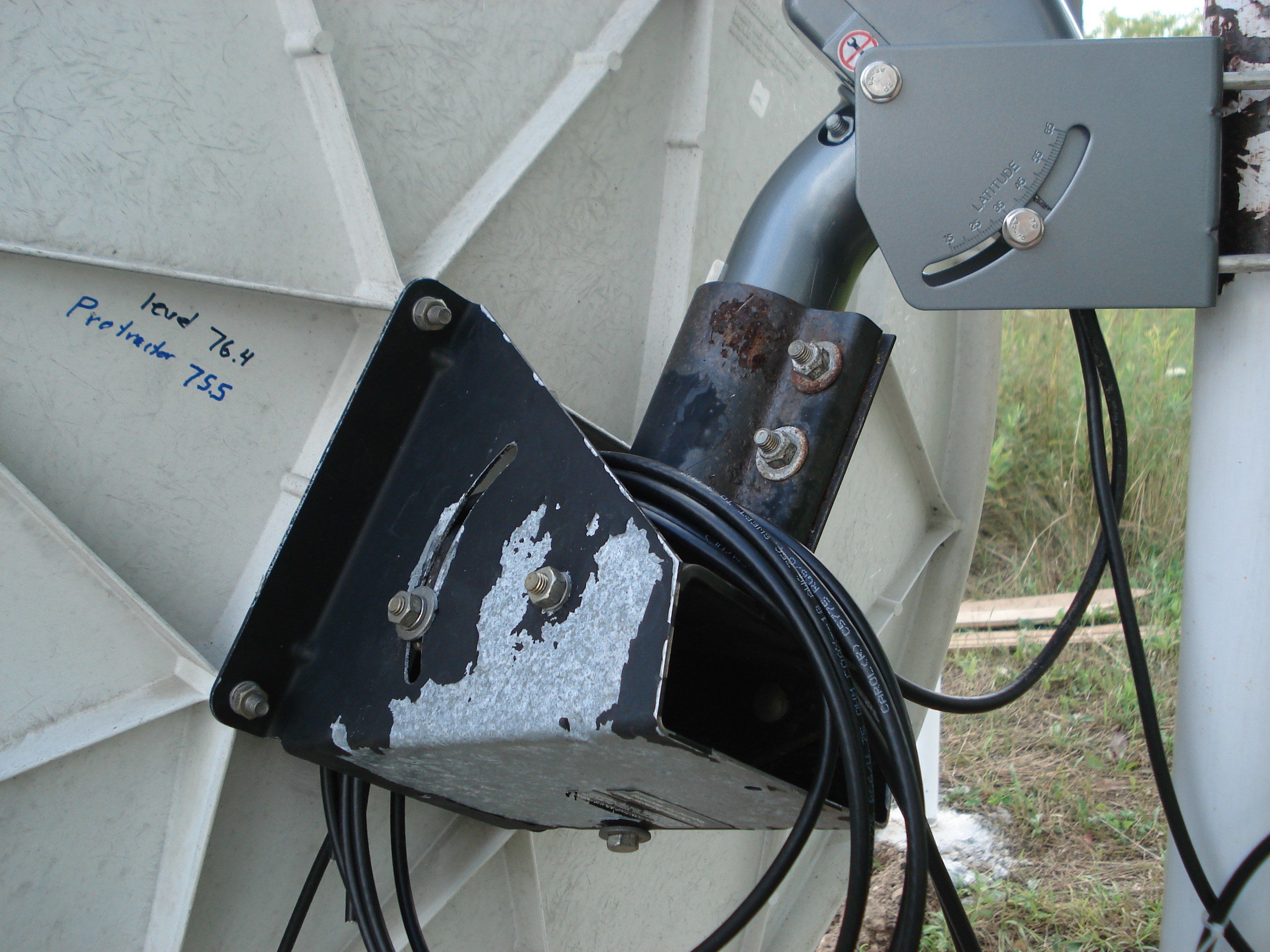

Here are some pictures of the motorized 1.0 channelmaster. I would like to find a better spacer to fit between the motor tube and mount.
Setup was a snap. I had already tuned in sat 83 and my due south sat is 85 at same elevation. I took one of the magnetic degree finders and laid it on the top of the mount by where it bolts to the dish and found 85 1/2 degrees. Then I took the dish off the pole and mounted the motor on the pole with the lat on the motor set to my lat. I then just flipped the mount upside down on the dish and cut a piece of 2 inch pvc the length of the 2 3/8 mount on dish and tried to get it to go around the motor arm, no dice, then cut it in half and slid the dish up the motor shaft with help of my 2 sons. I put the magnetic angle finder back on the mount and loosened the mounts bolts enough to set the new angle of the mount to the 85 1/2 degrees. Then changed the lnb to a dual universal hooked up a receiver tuned to the transponder on the LIST for sat 85 and a portable tv to the motor. The motor was on zero and I just moved the motor on the pole a bit and had 85. I tightened the bolts up and it was done. I get sats from 83 to 129. Have not looked for others yet. Do need to get a dual standard lnb so I can hopefully set it up some how for the 2 other receivers to receive from. I will have the receiver that moves it in my shackroom.

I used a plastic piece to shim in my clamp also, and found that in the winter when the temperature went down, the plastic shrank significantly and the dish became loose. You are much further north from my location (Virginia), so you may have the problem also. Just check the tightness as winter comes.
