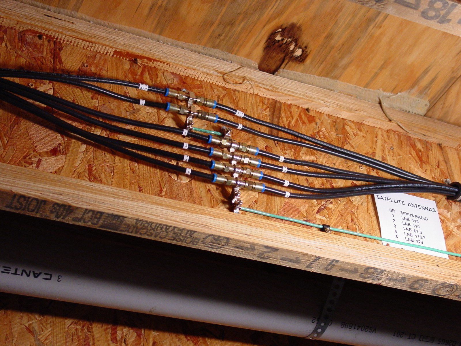

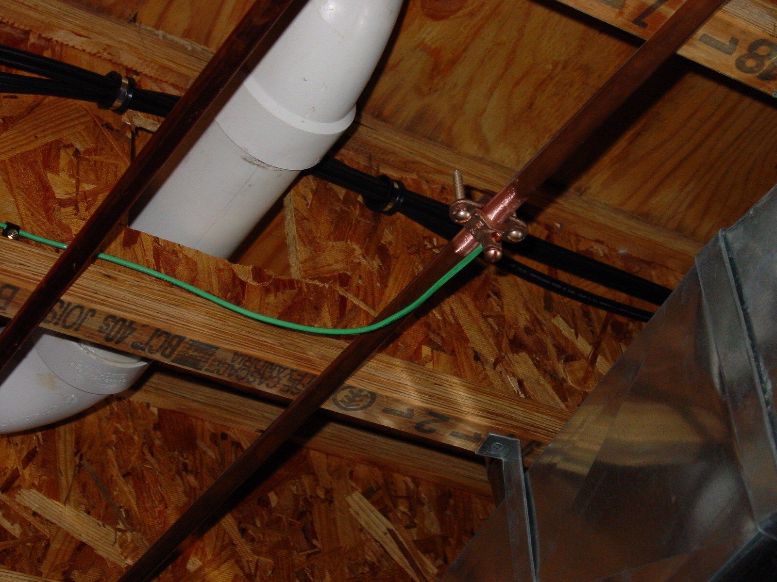

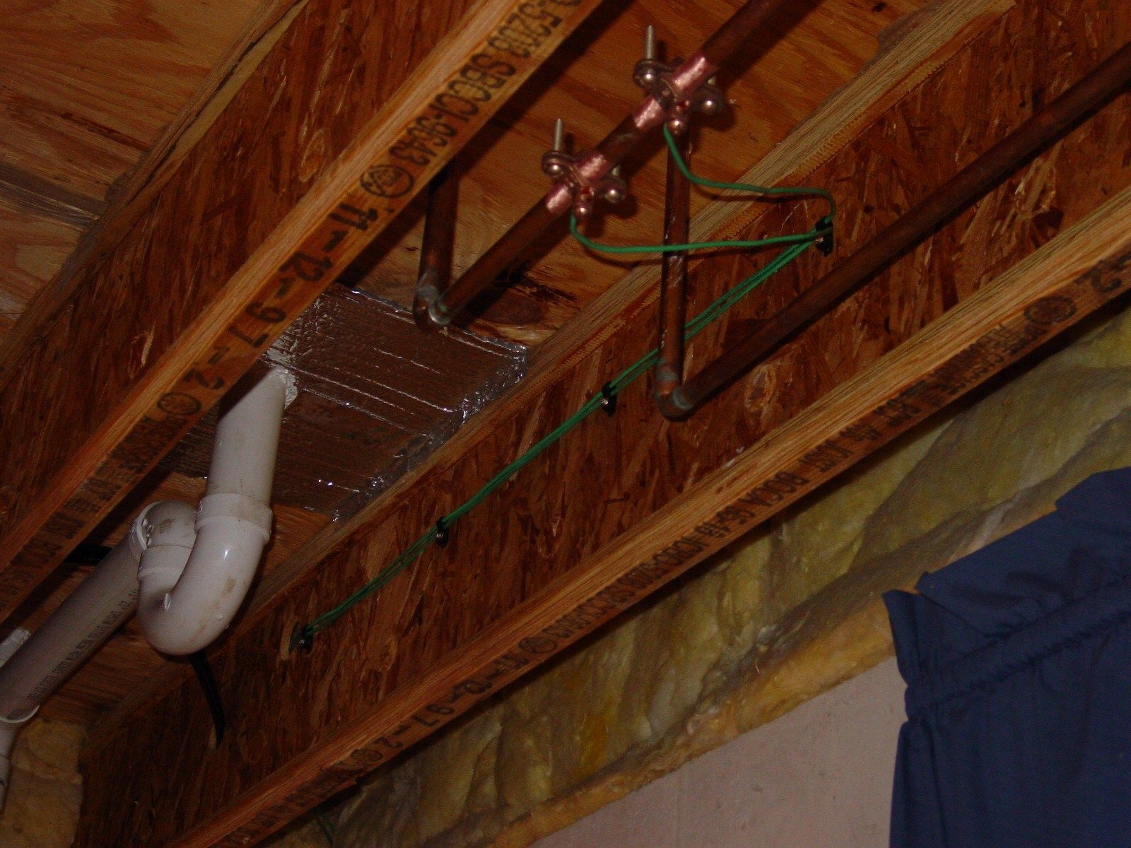

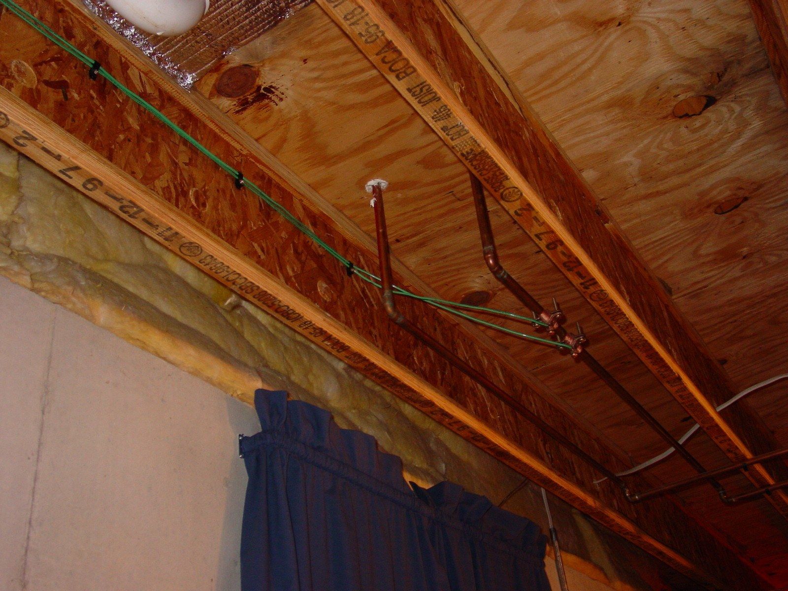

That is how I read the code too so I went with an inside job.
