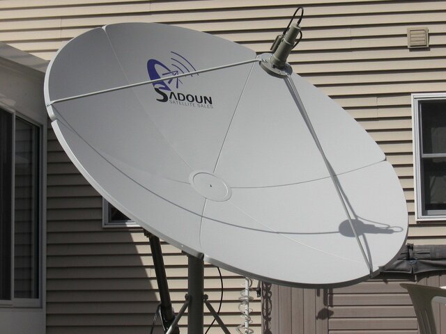

Lak! It dosnt happen on all but i would say more than a few.Heres a pic of my Dish with the LNB.PS i figure that some adjustment is still needed on my LNB but for now im just programming in sats.

Mine only does the double (both polarities) on one Sat and thats
103 with the oddball skew. I'm motorized so my skew is off on that
one. Not the receiver's fault.
