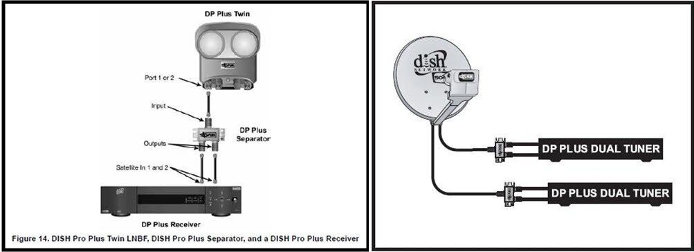

I have a Dish Pro quad LNBF feeding two 625 dual receiver DVRs and the setup has served me well for about 7 years. There are 4 RG6 cables running from the quad LNBF to the 2 DVRs (2 to each).
I need to upgrade the cables running to one of the DVRs – the stuff in place now is 20 years old ribbon cable in underground conduit (leaky) and probably isn't rated as flooded. My reception is getting dicey – I'm probably lucky it works at all. This seems like a good time to convert from dual wire to single wire flooded to the DVRs. I'm confused on how to do this.
The DVR end is pretty straightforward: run the cable from the LNBF into a separator and attach the separator to the 2 receiver inputs of the DVR. Easy Peasy. It's the LNBF end I'm confused about. How do I make that connection? Do I need to upgrade to a Dish Pro Plus quad LNBF; if so, then what? Or can/should I use my existing LNBF with a switch or some other device to combine the 2 wires into 1?

The upgrade is a DPP TWIN they never made a DPP Quad.

Looks like the DPP Twin is exactly what I need! For some reason I was thinking "Twin" meant it could only handle 2 tuners.:coffee
As I now understand it, each of the 2 output ports of the DPP twin can be connected to either a single tuner receiver or a dual tuner receiver with separator.
