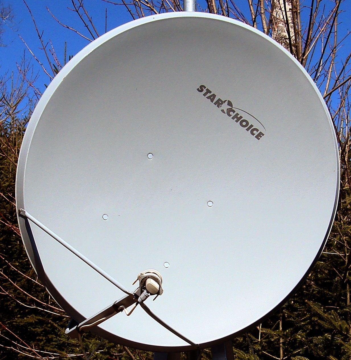

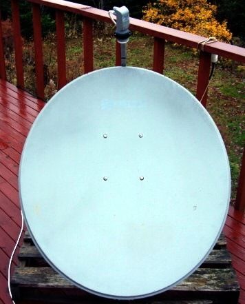

I have two Ku dishes that I use: motorized and fixed. I've always referred to them as 1-metre (39") dishes. Today I measured them.
The Star Choice motorized is actually 40" x 44" (1760 sq.in.) as I've known for a while. The Digiwave fixed is 35.5" x 40" (1420 sq.in.). But this is 100 sq. inches less surface area than a so-called 39" dish, and 340 sq.in. less than my Star Choice!
If I swap my dish reflectors/LNB arms putting the larger reflector on my fixed, maybe I can actually pull in NBC from 103W and PBS from 125W on my fixed. The satellite signals that I receive on my motorized are not so critical. And the slightly smaller reflector would be easier on my wimpy SG-2100 motor too.

I would be surprised if the FD and offset is identical between the two brands. Most likely the reflector swap using existing LNBF arms and clamp would not produce good results.
The reflected signal will probably not converge at the same point and the LNBF support arms would need to be repositioned, lengthened or cut off to put the feedhorn in the "sweet spot".
Might be a fun experiment if you have equipment to Frankenstein.
Back to kijiji to look for a free 1.2m then...
Added: Or, I could swap complete dishes. The Star Choice has always been too heavy for the motor anyway.

FWIW- I've noticed some 'rate' their dish size by the measurement of the vertical measurement. Which to me is = to <.3db NF LNBF's. The actual effective area is determined by the offset dish width.
Dish width is the important measurement I think. So my Star Choice is 4.5" inches wider and that's why it might work better. Hey...I'm going to move the whole go#$%@! Star Choice dish and motor assembly to where I now have the fixed Digiwave. Shorter RG-6 by about 150+ feet, easier to work on (even at night), can see the TV through the living room window and it'll work fine...until the leaves grow back in Spring. Spring is 6+ months away! With luck, I can get 83W through 125W on a motor and bigger dish too.

So the area of an ellipse - in the case of a satellite dish, of the elliptical cross section of the received and reflected signals - in the first instance is 40"/2 x 44"/2 x 3.14 = 1381.6 square inches., and in the second instance, is 35.5"/2 x 40"/2 x 3.14 = 1114.7 square inches.
Assuming equal efficiency, the larger dish, which is about 24% larger, will tend to have 24% more gain than the smaller one. A signal increase of 24% is less than 1 dB (about .93dB).

Since the Starchoice dish is an offset dish, it's effective size is 1m. I have posted in the past the measurements for checking your LNBF placement from a fax i received from Winegard.
The Digiwave DWD-90T
Items & spec DWD-90T (93.5CM)
Offset Angle 24.62
Aperture-Short Axis 85.0 cm
Aperture-Long Axis 93.5 cm
Focus Length 51.0 cm
KU-BAND Gain @12.45GHz 39.44dB
Elevation 20-60 / 23-90
Azimuth 0-360
Efficiency 70% min
Finish Polyester Powder
Color Gray/Cool Gray
Mounting Type G/W
Pole Diameter Acceptable 38-48
Ambient Temperature -40°C ~ +60°C
Relative Humidity 0~100%
Net/Gross Weight 8.6kg
Material Steel
http://digiwavetechnology.com/36-in...l-offset-dish-in-bulk-taiwan-digimonster.html
http://www.winegard.com/kbase/upload/X3e_21DF3126.pdf
No matter the size, its the gain spec that is the important number.
My Star Choice is 101 cm wide so it truly is a 1-metre dish. My Digiwave is 90 cm wide by 99 cm high. So it is not a 1-metre dish.
