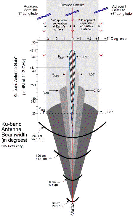

The main point being dishes being big enough to reject signals 2 degrees or more
See picture attached
90cm or 36" dishes are 2 degree compliant. The Winegard 76cm dish does a good job with gain so that this isn't usually an issue 'til it is like I think your having.
Most of us that were having problems adjusted our dishes a little east to block more of 125
