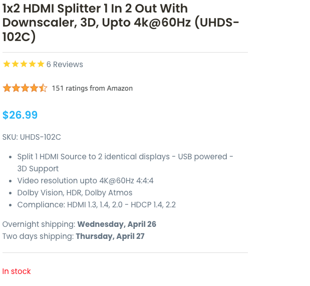

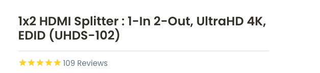

What I want to do is use a 1X2 splitter, HDMI 1 to the AVR (when I want full 5.1 audio), HDMI 2 to the TV (2 Channel audio through the TV speakers). That way I can choose when I want AVR ON and full surround, or AVR off and just 2 channel speaker audio.
I spoke to OREI and there concern is I may not get full 5.1 audio through the AVR with the splitter.
Can anyone give me any input on how these splitters might work, and which model is best?????
I have little experience with HDMI splitters. The one time I used one it had to be active, not passive.
I've used a few over the years. It basically fakes the HDCP and sends the signal to each output simultaneously. I believe it is most likely that it would pass through DD 5.1. You will likely lose CEC, the ability for your Directv to turn the TV on/off/input as it is powered on/off, if you are used to having that feature. Just makes sure it is an active splitter (has its own power source).
