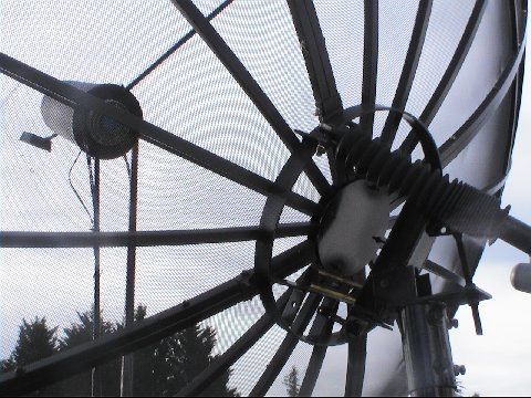

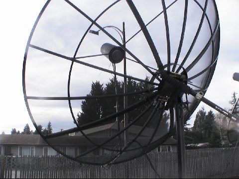

I need help about using my 1st BUD, which is 13 years old.
The 24 inch actuator are is 14 years old and it doesn't like the COLD
temp. and COLD breezy wind. When that happen, it STALLS!!!!
Can't move the dish. So what I've been doing for a solution, which is
a pain in the butt, is to go outside with a metal stick to tap or tap harder
onto the actuator arm gear motor, the back of the actuator arm to move
the dish. And that works as well.
I wish I have some kind of heating system that would heats up the BUD
so that the actuator arm wouldn't be stalled. It likes summer!!!!

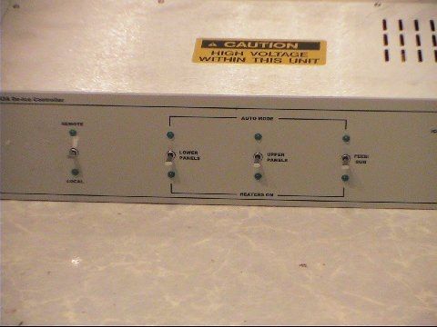

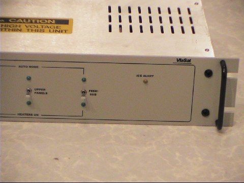

But I happen to found which I FORGOT ALL ABUT IT, I bought a heating
system on ebay. And I am wondering whether are you familiar with it and
whether can you help me with it???
I include photos attachment for you to see what I have.
I forgot all about it, this was 5 years ago I bought it on ebay.
And I am wondering if it possible for using it for my BUD.

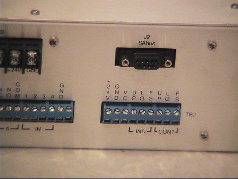

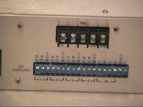

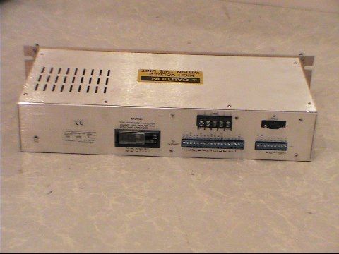

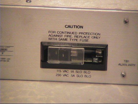

However, the hearting system does not include the power cord,
and it doesn't include the cable that go from the rare end of the heating
system to go out to the dish.
No power cord and no heating cable line.
I'm hoping a heating cable would be something simple.
Either a magnet or clamp that go onto the back of the BUD.
And it should heats up.
Would Home Depot or Lowes have the type of heating cable
for this heating system I got.
See include photos. What do you think???
The heating system brand make is:
"ViaSat"
Model: 8243A
De-Ice Controller.
Hope all helps with answers.

Looks like the OP has a commercial grade de-icing system. It's not intended to heat the actuator but it is intended to keep ice and snow off the reflector.

Everyone has good suggestions, and a commercial heater is meant for heating a SOLID dish. Mesh antennas will not conduct heating elements to any useful degree. A heat tape wrapped around your actuator tube would be a cheap band aid solution that can be connected via an extension cord to an indoor power source.
But the main issue is your actuator itself, which was probably designed for a five year lifespan. 14 years and still working is very lucky, but I would not put it through another winter. Your tube is likely to be very worn out and the contacts within the motor itself are probably on their last legs. Consider replacing with a heavy duty 24 inch actuator such as the Ball Screw version of a VENTURE brand unit for a long term future.

I've never heated the actuator or anything else, and I have had it working for many years in -35F in winter and up to +100F in the summer... I don't turn the dish unnecessarily in the very cold temps though, I leave it parked where I am most likely to be using it. I also cleaned out the old grease (actuator gears and screw) and replaced the lube with Lubriplate (available at the time) for cold weather. Think there is better "stuff" available now like SuperLube PTFE. I have used the latter on DISEqC motors and works just fine. Comes in a 3oz tube or larger.
Original grease is generally made for warm climates and can "freeze" below 0 F, especially if it has absorbed moisture, or becomes so viscous that it overloads the power supply that runs the actuator.
I have a spare actuator, but if the Von Wiess I am using now ever fails I would likely replace it with the Ball Screw unit Mike suggests.

the heat tape works very well, get the shortest one you can find, I use one that is 3 ft long if any longer you have to wrap it around itself which is not good, wrap it on the tube that the worm gear travels in and out, keep the temperature control near the bottom end, use electrical tape to hold it to the tube, get a piece of pipe insulation and cut it the length of the cylinder, the pipe insulation will be split the length of it, close it around the heat tape and secure with electrical tape, make sure the temperature control is inside of the insulation this takes care of 2 problems, if it is hanging outside, the heat tape will run steady and get hot enough to melt any plastic, if it is inside, it will control the temperature and the tape will run only the time needed to keep the arm warm, I have been using mine for many years and it works very well, however, the arm should be removed in the summer time and re-lubricated, then it will last many years
