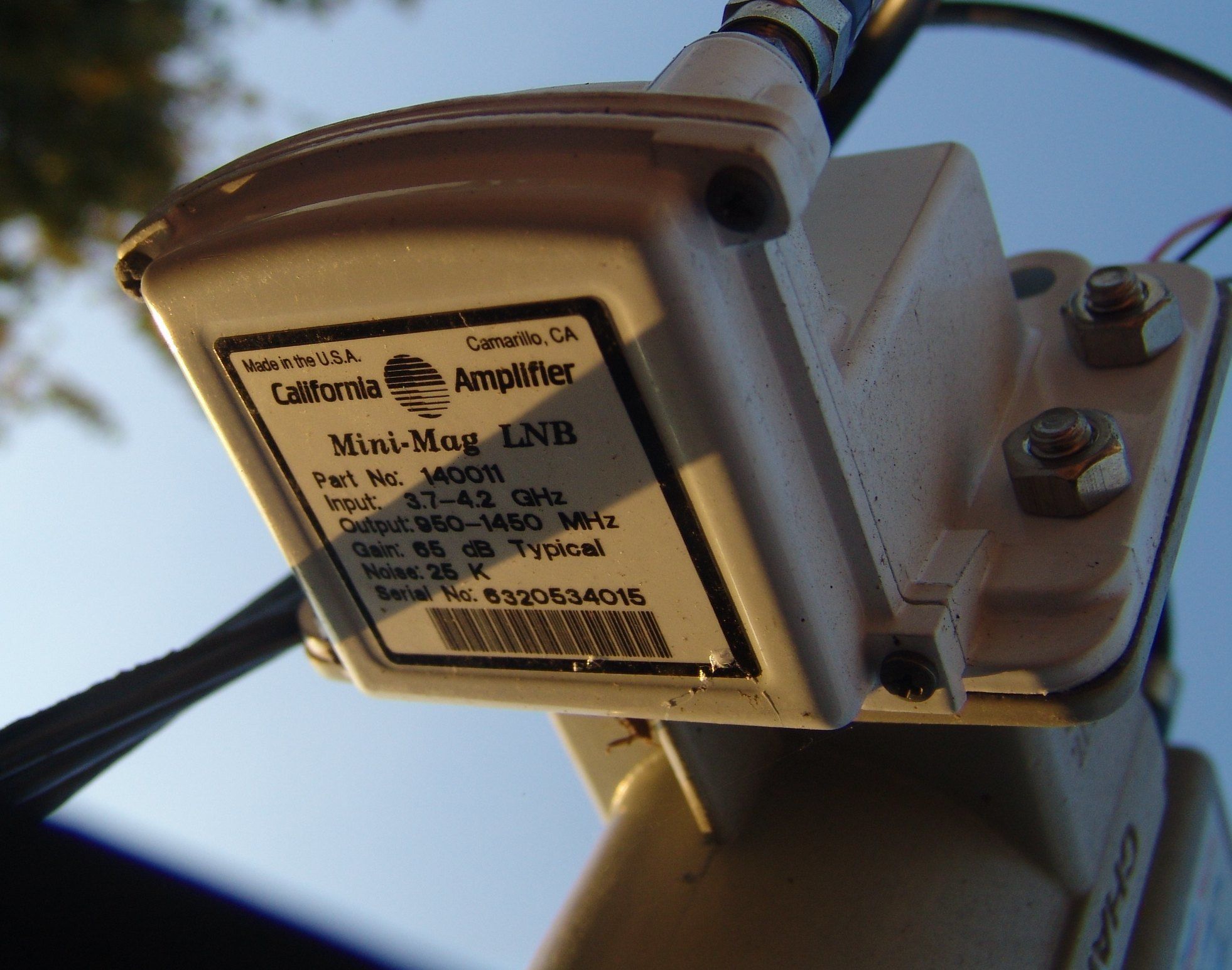

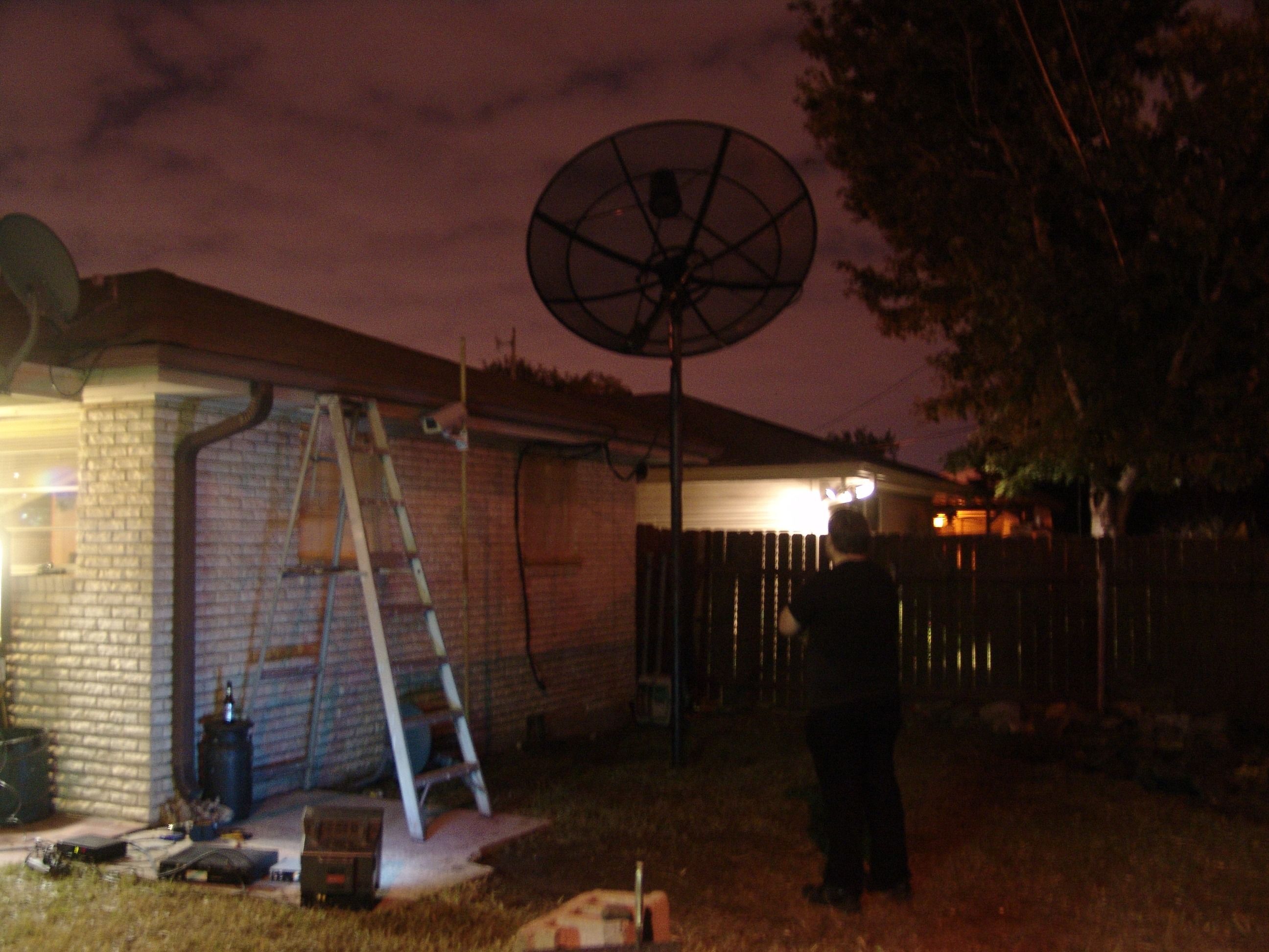

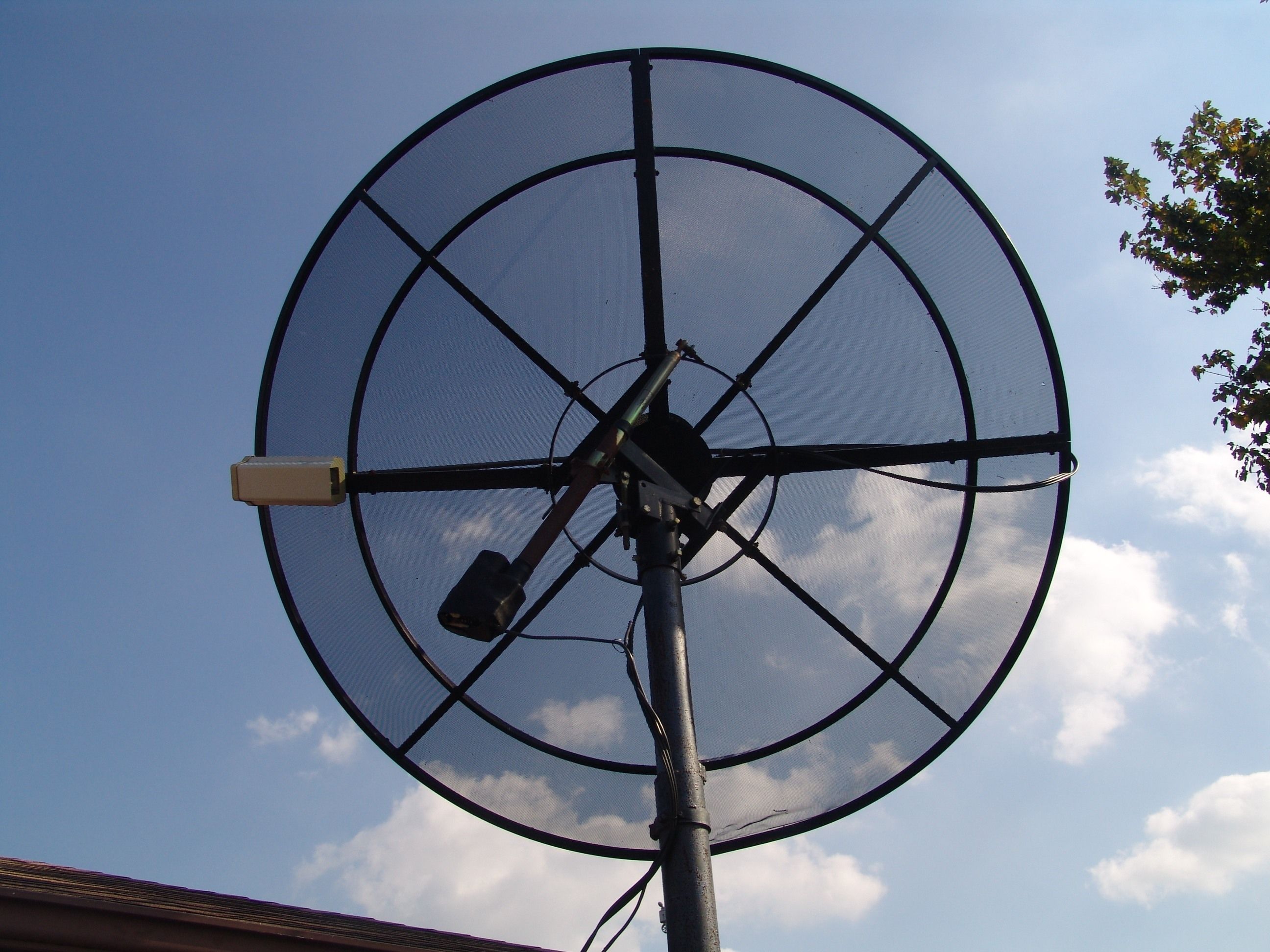

Ok here we go..
One of the pics is blurry and I am not going back up there, my neighbors are already paying too much attention to the dishes that seem to be popping up in my yard. The Ku LNB seems to be an Aspen.
The C-Band is a California Amplifier Mini-Mag LNB PN 14001
The Mover is a Von Weise Satellite Actuator
Feed Horn is Chaparral and the Dish is HomeCable

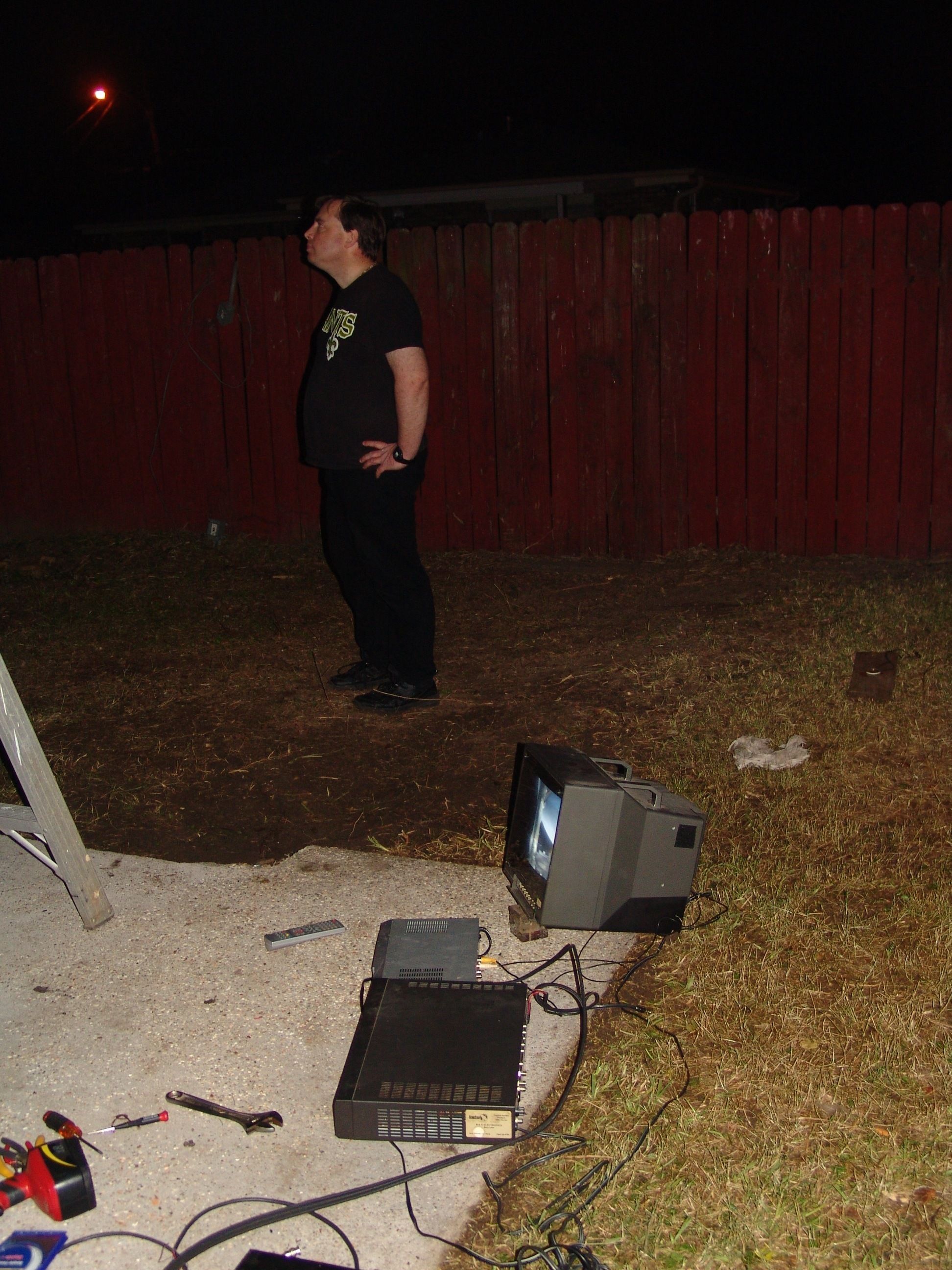

Pictures include a candid picture of Tron looking at the Bud we aligned. It took 5 people to pick it up and place it onto the pole.. I know I know..
You can clearly see the damage to the dish in DSCN9880 but dont seem to affect anything as I have 80-90% quality signals..
I am using a PROSAT 210 to move the dish, a General Instruments VCII 2400R to control polarity for now and my Buzz FTA receiver.

say WHAT ?
What the hell did you do?
Put a camera on the dish?
No wonder the neighbors are coming after you with flaming torches and pitchforks. :eek:
And as for putting LEDs on the dish, I really wouldn't do that.
It just works as a good aiming point for night shooting. - :eureka
I do a lot of shooting at night around here, rats everywhere! Bait and shoot. No LEDs but the camera gives me reference as to where the dish is because I have no feedback from the actuator arm. For the most part, its the new neighbors behind me that is wondering what I am doing, the old folks behind me as well think we are nutz, maybe they are right?

The Cal-Amp 25K is a pretty decent C-band LNB. If the Ku is an Eagle Aspen .6db you are in pretty good shape there too.
If the dish is a full 8' from rim to rim, it is more than likely a Unimesh dish with the Home Cable label on it.
The little bit of damage to the outer rim won't hurt C-Band much, and the Ku might not be affected too much either.
The main thing is that it is working. :cool:
