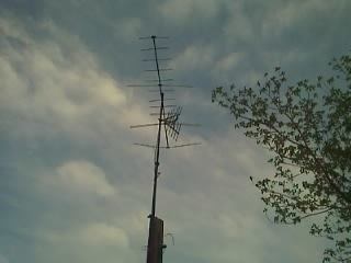

I have (2) antennas mounted on a telephone pole next to my house. I recently hooked them up to an analog TV just to see what I could find. There were a few channels.
I live in Elrod, AL 35458

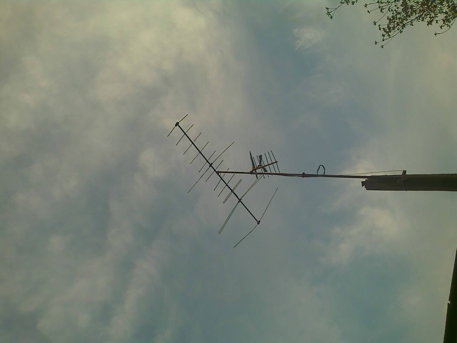

I know there aren't a lot of channels around my area, but some are better that none. I have attached pics of the antennas. I haven't seen any sort of pre-amp on the pole or in the attic. The antennas are joined by a "splitter", not sure of any specs until I lay this thing down and get a good look at it.
The antennas are about 30-35 feet off the ground.
So I guess my questions are:
Should I use one or both of the antennas?
Should I build or buy a new one?
What kind of pre-amp should I but?
Will it even be worth the trouble?

I can tell by looking at the pictures that your antennas are very, very old. If you want good results, you need to replace them. I recommend that you start with Winegard HD 7694P High Definition VHF/UHF HDHD769 Series Antenna (HD7694P) | HD7694P [Winegard] and aim it towards Birmingham (east-northeast direction). To make up for downlead loss, add Winegard HDP 269 SquareShooter Pre-Amplifier for SquareShooter SS-1000 (HDP-269) | HDP-269 [Winegard] . You will also need new RG-6 coax for your downlead ( Solid Signal Custom Cable Lengths RG6 Quad Shielded with High Quality Solid Signal Connectors (SSCBLQ) | SSCBLQ [Solid Signal] ).
You can get manuals at: HDTV Home Antenna Preamplifier Preamp Accessories - Winegard and HDTV Home Antenna, 30-50 Miles, VHF, UHF, HD7694P, Yagi - Winegard
My recommendations are based on "best performance for the money". There are larger/better antennas that capture more signal, and there are better pre-amps that have more gain and lower noise. But they cost more.
The question is how much do you want to spend VS how much will you receive. TV Fool shows ABC/CW/CBS & PBS as the most likely channels you could receive.
The antennas you have now look old but in photos probably good condition. The long one looks to be a VHF (CH.2-13) and the "V" shaped on is UHF (CH 14-69). More than likely they need to be removed and brought down to ground level and corrosion removed from contact points. Probably will need new "BALUNS" to replace existing and a new "UVSJ" combiner to couple the antennas together.
Is this worth it or should you just put up new antenna? Personally I would replace them and start from scratch but is it worth it for limited reception? Do you already have a digital converter or is that an additional expense?
