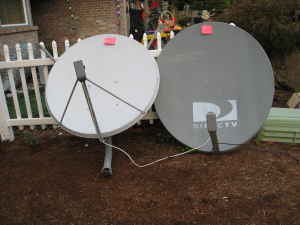

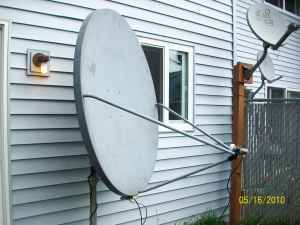

I am looking to buy a new (used) dish and would like to see which would be the best choice since I could only afford one.
I will attach pics :)
I will list three of them and any info given to me by the owners.
Dish # 1 white metal, unknown brand 43" inch unknown LNB
Dish # 2 Grey DirecTV fiberglass dish 48" inch unknown LNB
Both these dishes are $50 each or $100 for both (same owner)
both have the mounts and one has a mast as can bee seen in the pics.
Dish # 3 1.2M Channel Master fiberglass unknown LNB asking price $65
previously used for KU reception according to the owner cost includes the pole.
I know that channel master is a great brand but I would like to eventually motorize the dish as money becomes available and worry about weight and cost issues to motorize the dishes.
(The channel Master is not currently motorized)
I'm leaning towards the white dish due to lightness but am worried I'd make the wrong choice since all three seem good to me.
Any help or ideas on this one??
thanks in advance to everyone.

Never seen a directv dish that big! So I couldn't really comment on it. I'd go for big as you can get, but that's just me. One meter dish should be just fine for ku-I'm using an old primestar that is just under 1m (.90M it says on back) and I don't have any problems picking up most of the fta signals I've found. Naturally the 1.2meter dish would likely give you even more signal and margin against rainfade, but a strong enough rainstorm will wipe out most any consumer sized satellite dish. If the 1.2 is a fiberglass or composite dish, it wouldn't be too heavy for a good motor, like the DG380, once you remove the excess metal from the original mount.
The Directv dish is meant for Hawaii or Alaska from my research.
I believe it's around 50 to 60 lbs with the mount. Weird no support arms on that one..
opinion:
I'd say any of 'em would be good choices for reception.
The white is big enough, but I don't recognize it. Maybe one of the members knows it.
The Primestar/ChannelMaster 1.2m dish is outstanding, and we can help ya find a big enough motor.
Removing some of the mount will probably be needed, too. That'll lighten it for a motor.
That DirecTV dish is one I've been trying to get my hands on.
I've seen some in Mexico.
Personally, I think those prices are a little high.
But if you get some cable, a non-penetrating roof mount, or other value with one, it'd be attractive.
They are not so high that I'd dismiss 'em, though. - :rolleyes:
For the sake of comparing apples to apples, I would point out that 48 inches = 1.2m. And I think the Channelmaster also weighs in at around 60 pounds, so from here it looks like the CM and the Directv dishes are the same animal, except for the LNB support.
<> The CM has a 40mm LNB holder, and it appears the Directv has the D or rectangular style holder. The 40mm holder is going to be much more versatile, since those D/rectangular LNBs also tend to have 40mm necks.
<> The CM also comes with a mounting post? 6 feet of schedule 40 steel is worth about $80 the last time I checked. Prorate accordingly, but this means...
I'd rule out the Direct dish (if you can only buy one).
So we're down to the unknown smaller metal dish and a 1.2m CM. Time for some Full Disclosure: I own a 1.2m CM dish, and swear by it. Best thing I've ever has the pleasure of receiving Ku with.
Some here have even had success receiving C-band with them. Motorizing is a concern, however, as you've rightly pointed out. I decided to go with a Jaeger H-H 1224. Problem is they are not widely available in the states and they are expensive. Others (as turbosat suggested above) claim a regular diseqc motor (DG380-heavy-duty-type) will be sufficient to move it, although my suspicion is that they will be painfully slow. Heck, I have a lighter motor on a much lighter dish and it is painfully slow!
Your other option is the (apples) 110cm (43") metal. And cost is your primary concern?

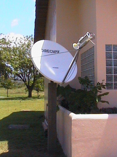

I have 3 Hughes/Direcway 1.2M dishes given to me but no az/elev mounts or LNB arms or anything just the bare dish alone.
If I had the measurements I would try to fabricate my own hardware.
I will included a picture of the exact dishes given to me, off course mine are bare no hardware...
If anyone really wants I can take actual pics of my dishes for you guys to see/compare.
They measure roughly 54" X 48"
I appreciate your opinion on the prices, but wonder why you'd choose the directv dish instead of the other ones? Also shipping would kill me if I don't buy locally since I'm on a fixed income.
Guess all is left is the 1.2m channel master now or just perhaps waiting for a better deal?
sorry if I wasted anyones time, but do appreciate everyones kindness and help.
Should I go for the channel master??

- it's very possible the Craig's List fellow pulled the advert so he wouldn't have to hear from others, 'till after you've decided.
I wouldn't write him off if he said he'd give you 'till Friday.
- nothing wrong with the 1.2m (four foot) ChannelMaster/Primestar dish.
And, the pole is a big plus!
- you certainly don't need a larger dish than 1m (39") or 1.2m (48")! - :eek:
- considering the dishes you've got, they could be used for pretty close to free.
If you post (bigger, actual) pictures, I'm sure you can get help here figuring out how/where to mount an LNB.
You have to decide if the cost of these dishes is worth it to you, versus making one of yours work.
Do you want to do the work?
edit: I think all your choices are good quality dishes.
- why do I like the DirecTV dish? Because I hope to get one (some) for somewhere between free and $20.
But, I'm a cheap &@$!@%)
Hey, a fellow's gotta have goals! - :D
There are great BUDs out there for F.R.E.E.!. - :eek:
...and there arealso many Ku dishes for free/cheap, too.

Looking at the back of his dish it sure looks like the same as mine other than a different mount.
I wonder is it common that a manufacturer would make the same exact reinforcing braces on the the back of his dish on different size dishes ???
His dish is branded Directv 1.2m, mine is Hughes/Direcway 1.2m
(Same company I think)
Take a look and see if it looks same to you if you have time.
His measurements are:
Quote,
"The side arms are approximately 41 inches from the bolt on the dish to the bolt on the main arm.The main arm is 31 1/2 inches from the bolt on the dish to where the side arms connect.
The main arm extends another 10 inches or so until you reach the actual end.
The measurements are within a 1/2 of being exact"
-unquote.

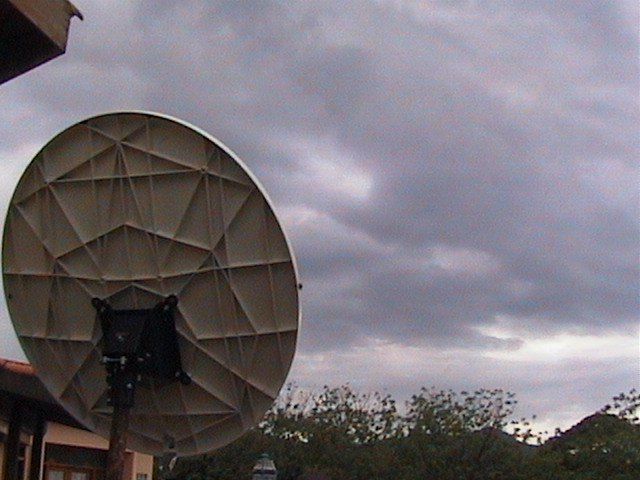

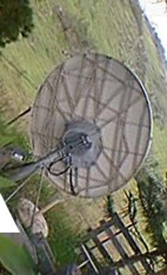

Picture # 1 is definitely like mine as far as the support braces on the back and the writing on the front is concerned.
Picture #2 is his 1.2m directv dish low quality pic, sorry...

can someone confirm the 1.2m directv and my 1.2m hughes/direcway are the same dish by looking at the pics???
Hi Dan70 and the group, looks like to me the one in the left picture on the side of the house may well have a linear LNB on it and looks to be a standard FTA dish. If so it would be best choice if you want to add a motor.

Your 1.2m directv and my 1.2m hughes/direcway dishes are not the same, so far as I know, and are built by a third party dish company.

I understand about third party manufacturing for Hughes, Direcway etc.
But these two dishes look the same to me in these two pictures.
The reason I'm asking is because the guy gave me the measurements for the LNB support arm and side brackets. (is that what you call them?)
and I don't want to waste materials and money if possible building the parts,
since I will not buy any of the dishes mentioned previously.
The guy that gave me the measurements said it's a Directv 1.2m dish and mine are also 1.2 meter but branded Hughes/direcway.
They look the same to me other than the mounts.
Anyone else see that or is judging by pictures a poor strategy?
It's all I got to go by for now though.
Please look at the two pictures and give me an opinion before I go cutting and drilling things :rolleyes:

Got a call from him today and ended up buying the 43" white dish for $40
I was going to wait but couldn't pass up his offer.
I apologize if I confused anyone, seems I confuse myself at times :)
Anyways the dish measures roughly 43" X 40" and is no name brand, steel/metal.
It does have U-Bolt type rear mounting hardware, similar to many FTA dishes out there,
that can accommodate different size poles, and came with a circular LNB.
Also came with a large diameter J-Pole with it's support brackets.
All in all I think I did well...I was going to wait but couldn't pass it up; save on shipping etc..
All seems in good order other than some wear on the paint in places.
One thing though, the elevation scale is throwing me off, no numbers just says
each line = 5 degrees, well I wonder is the first line 5,10,20 etc...???
Oh well I will get to reading the forums and see if any advice has been given so far.
To sum it all up, I'm very grateful for the honest advice given here, it was direct and really made
me think what's practical and not just buying on impulse, something I will definitely remember
in the future. Thanks to everyone for helping and looking out :) :)
