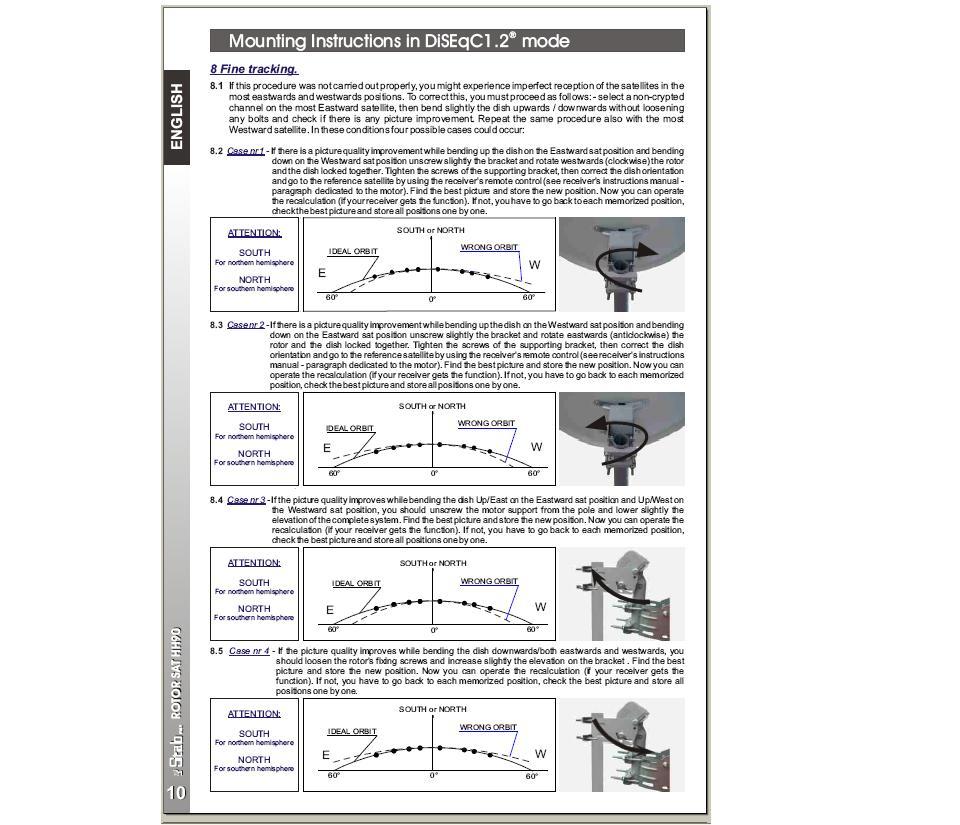

an interesting comment is that it mentions to adjust the motor elevation and leave the dish elevation alone. I was allways told the oposite. set your motor elev to your lat and fine tune elevation using the dish...
any comments from others ?
missing step: declination
I read over the section of the Stab manual in question, and it seemed to leave out an obvious step.
So, if you were to follow the instructions to the letter, you'd be doomed to failure.
If what I'm about to say is elsewhere in the manual, please point that out.
It damned well should be located -with- the above info on page 10 of that PDF.
Section 8, Fine Tracking.
In 8.2 and 8.3, the info is substantially correct for curing the problem described.
You twist the motor on your mounting mast to bring it into alignment.
That's not hard to understand, nor to accomplish.
For 8.4 and 8.5, where you raise or lower the motor on its mount , you must then apply a counteracting adjustment to the elevation of the dish where it's mounted to the motor shaft.
Go back to (for instance) your south-most bird (or a close one), and tweak the dish's elevation.
What you are actually doing is changing the declination angle of the dish, leaving it still pointing to the same bird.
That is exactly what is required to cure the problem where you are high or low on both ends of your travel, but right on at the middle (south).
Back in the c-band days, you always set the declination(dish elevation) and leave it, do adjustments with the elevation bolt on the polor mount. It seems to have changed with the little dishes.
That Stab chart is confusing, the first two diagrams are pretty self-explanatory, but I think the last two are reversed(wrong).
It wouldn't surprise me a bit if that advice (tweak the motor elevation) is a misprint or incorrect translation from another language. The instructions for most FTA equipment are not worth the paper they are printed on.
The good thing about the Cband dishes is that the two adjustments were reasonably independent.
On the H-H motors, they interact.
The only way to change your Ku declination to get it right (assuming you are targeting your southern bird), requires you to change the motors elevation, then do an opposite direction adjustment of the elevation on the back of the dish, to bring it back onto the satellite.
More I think about it, that's what you do on a C-band dish, too
At lest there, you can dial in declination if you need it, often by using washers to shim the mount.
If you follow the printed literature, and leave the motor alone, but adjust the dish's elevation, you are doing two things:
. adjusting the elevation of your beam
. adjusting your declination
That can't be good, and may be a reason so many people have trouble finding the arc.
