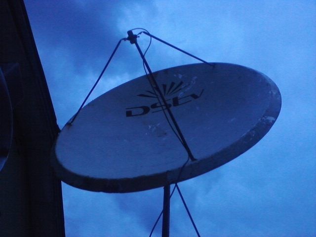

Hello friends, am facing a big problem, trying to tracking MBC frequencies with 180cm (1.8m) dish, with ku-band LNB installed on it.
the frequency am trying to track was 7.0°W Nilesat 11938.00 polarity: Vertical, symbol rate: 27500 and 7.0°W Nilesat 11766 H 27500.
have done all what i no but i couldn't get through plz GURUS help me out.

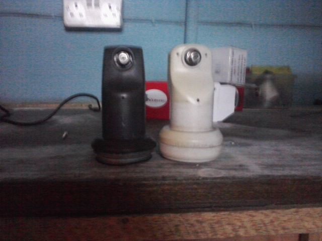

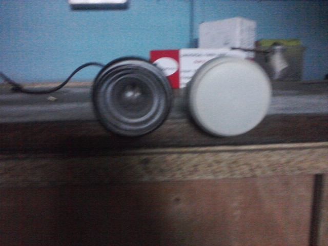

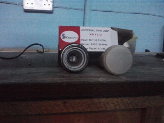

FRIENDS LOOK AT THOSE PICTURES...
MY DISH IS MADE OF FIBER AND IT'S 180 CM
I USED KU-BAND LNB BUT SOMEONE TOLD ME THAT THE LNB WONT WORK WITH THE DISH.
PLZ WHAT KIND OF DISH WILL I USE.

From the looks of the LNBFs you have pictured, It appears they are designed for an offset dish. An offset LNB will not work to well on a Prime Focus dish such as what you have pictured. There are Ku band LNBFs that are specially designed for use on a Prime Focus dish. This would get you the much more stable results than what you were trying.
On a different forum this one was mentioned: Strong Universal Prime Focus LNBF, (SRT L708)
Invacom makes a pretty good Prime Focus LNB, but it requires a separate C120 flange: Invacom SNF-031 'C120' 0.3dB Prime Focus LNB

You have a Prime focus dish, but are using a LNBF meant for an Offset dish. Your LNBF is only seeing a small percentage of the dish. You need a LNBF designed for a Prime Focus. Invacom feedhorn with a good lnb maybe?
