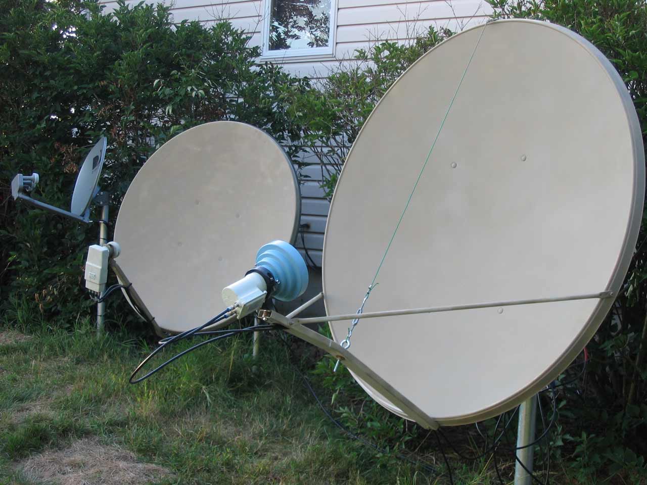

You might want to invest in a conical scalar ring, if you haven't already. It adds about 15Q to my miniBud reception and makes it actually useful. Mine is a 1.2M dish, and in the pic the conical scalar ring is the "blue" thing on the lnbf. :)
[edit] One thing to watch for, on your lnbf the correct orientation is for the arrow, or "0" point to be either at 9:00 or 3:00 , to have your polarity correctly aligned. That seems to be a GeosatPro standard .
