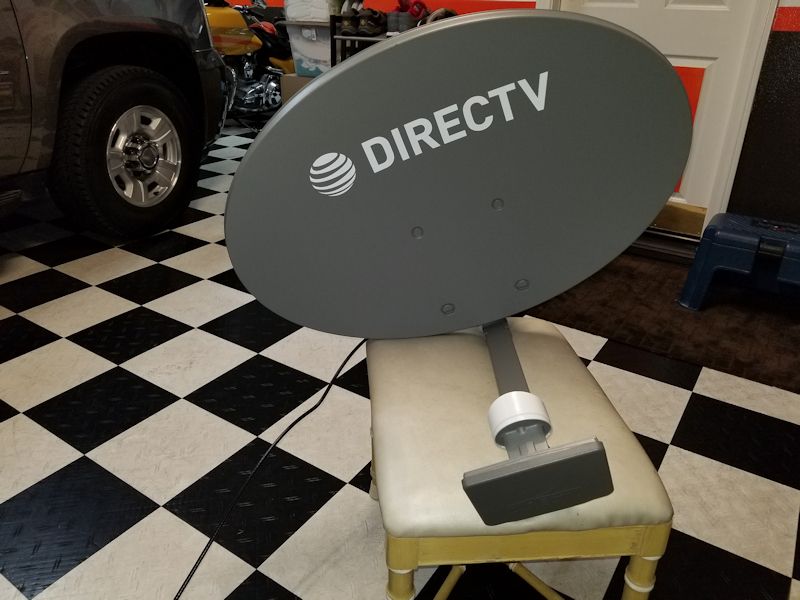

The dish was advertised as a Slimline but it doesn't say Slimline on the dish. It looks just like the one attached to our house which gets 95's.

slimline.jpg This is a slimline dish. There may be a different logo on it.

I am posting a picture of the dish.

Please look at the picture of my dish and tell me if I should be concerned that it doesn't sat Slimline on it.

It's a slimline, no worries.
