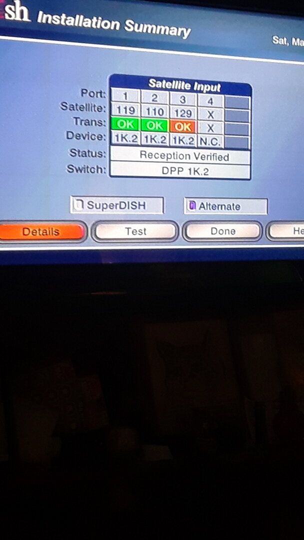

I have all 3 lines going to the switch. It's only finding one satellite . The check switch says I have 2 locations but one is all in red . It should show 3 .

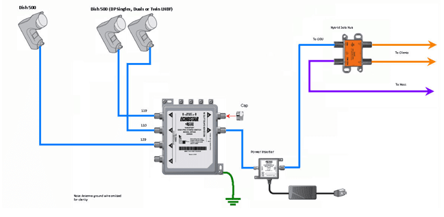

It's hard to say without being there, but I did a trouble call on 5 Wallys connected to a 42 switch and each one took multiple hard resets and check switches before they worked correctly. You have the power inserter in the right place?

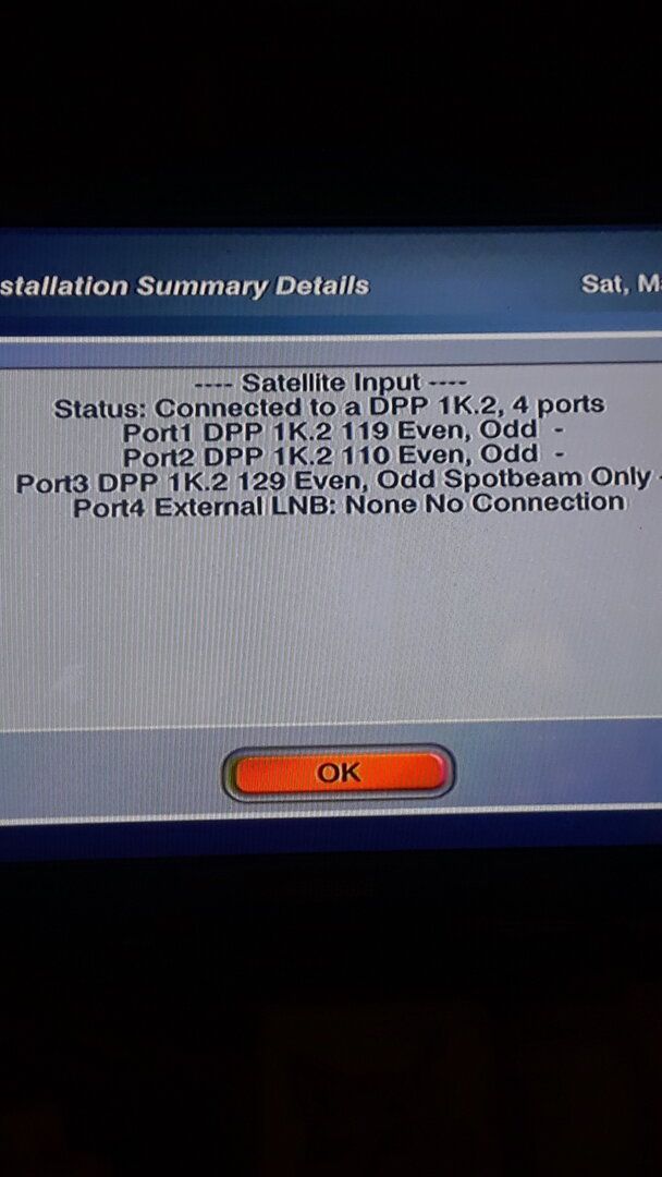

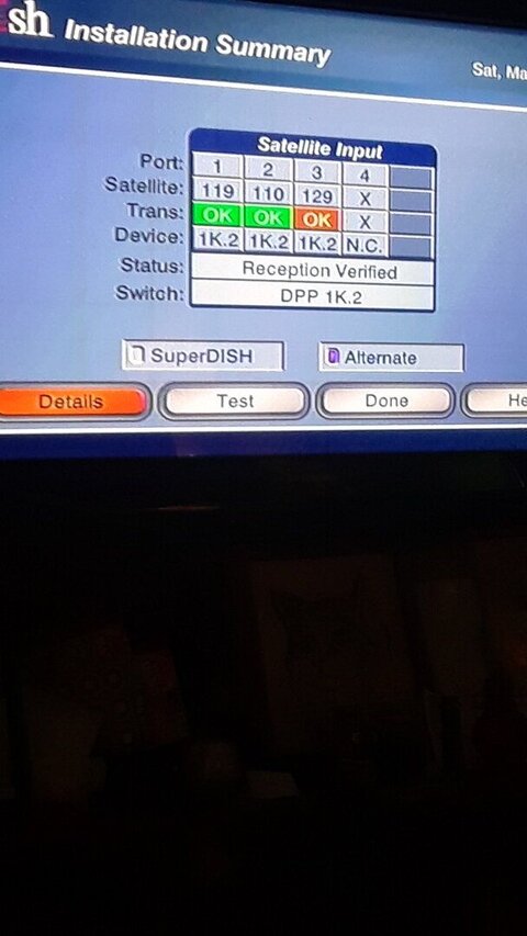

Still working on it. I get this,
Some of the channels that I cannot receive, 183,182.184, 170, 139, 120 112 110 108 107 31 209 214 217 232 237. No HD channels.

Do you know which lnb is receiving signal. If not, you can put tin foil over two of thge lnbs and then switch the tin foil around until you determine which lnb is receiving a signal. You might have the dish only picking up a signal from the incorrect lnb. After you figure that out you can move the dish over one way or the other to get all three signals.
