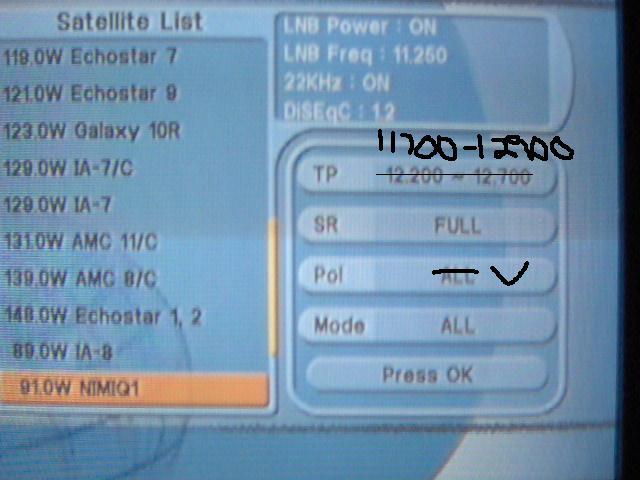

second way is to leave the LNB frequency as is but in the blind scan change the info to such
select the TP range and change it to 11700 to 12900 and hit OK
scroll down to "pol" and select "v"
hit OK
should allow it to pop in

Thanks Iceberg, doing this with the manual scan reveals that my signal quality it is in the red (5-7%). I will adjust my dish and then try again. May be a few days from now. Going back on the road till saturday or sunday. thanks Jason

For blind scanning with a 10750 LO just scan 11700 - 12900 horizontal. This scans the normal Ku vertical at 11700-12200 and the stacked horizontal 700mhz above this at 12400 - 12900.

Iceberg, the manual scan worked after I adjusted the dish. Thank you very much for your help. Jason
