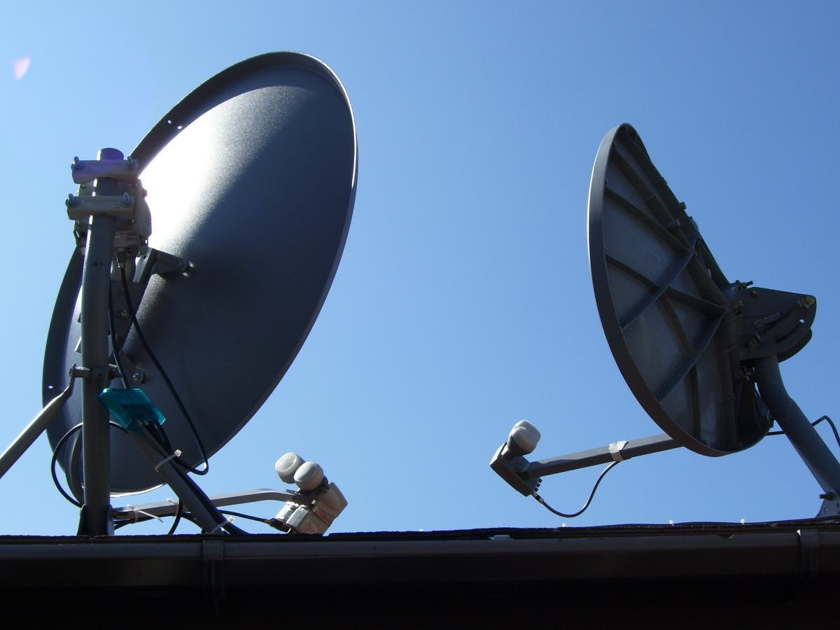

nah. The dishes actually "see" about 22-25 degrees higher than what it looks like when you aim the dish. Hence the name "offset dish"
yes, but the dish at 27.3 elevation looks like properly level, it like seems that there is not elevation at all.
understandable...where I live its 9 elevation...thats the dish on the right in the first pic :)
(the one on the left is at 148W)

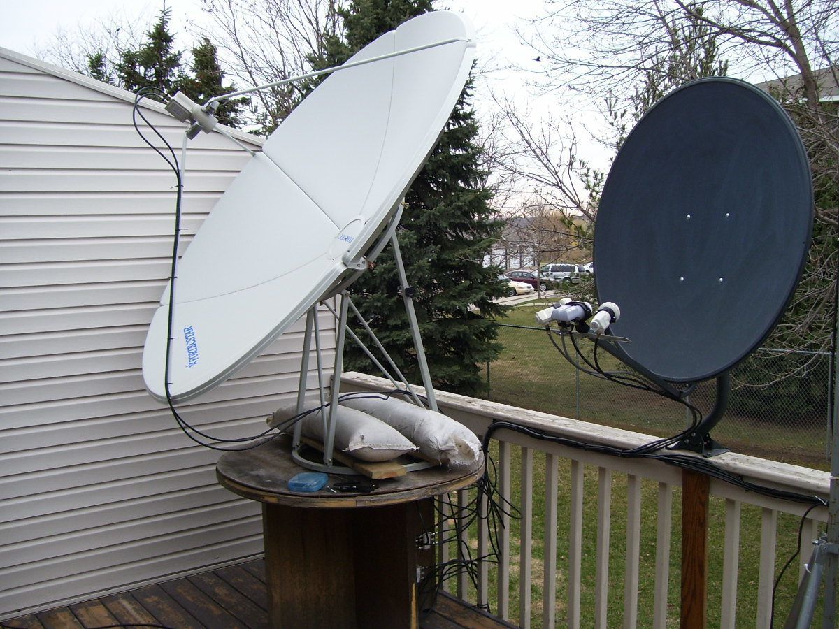

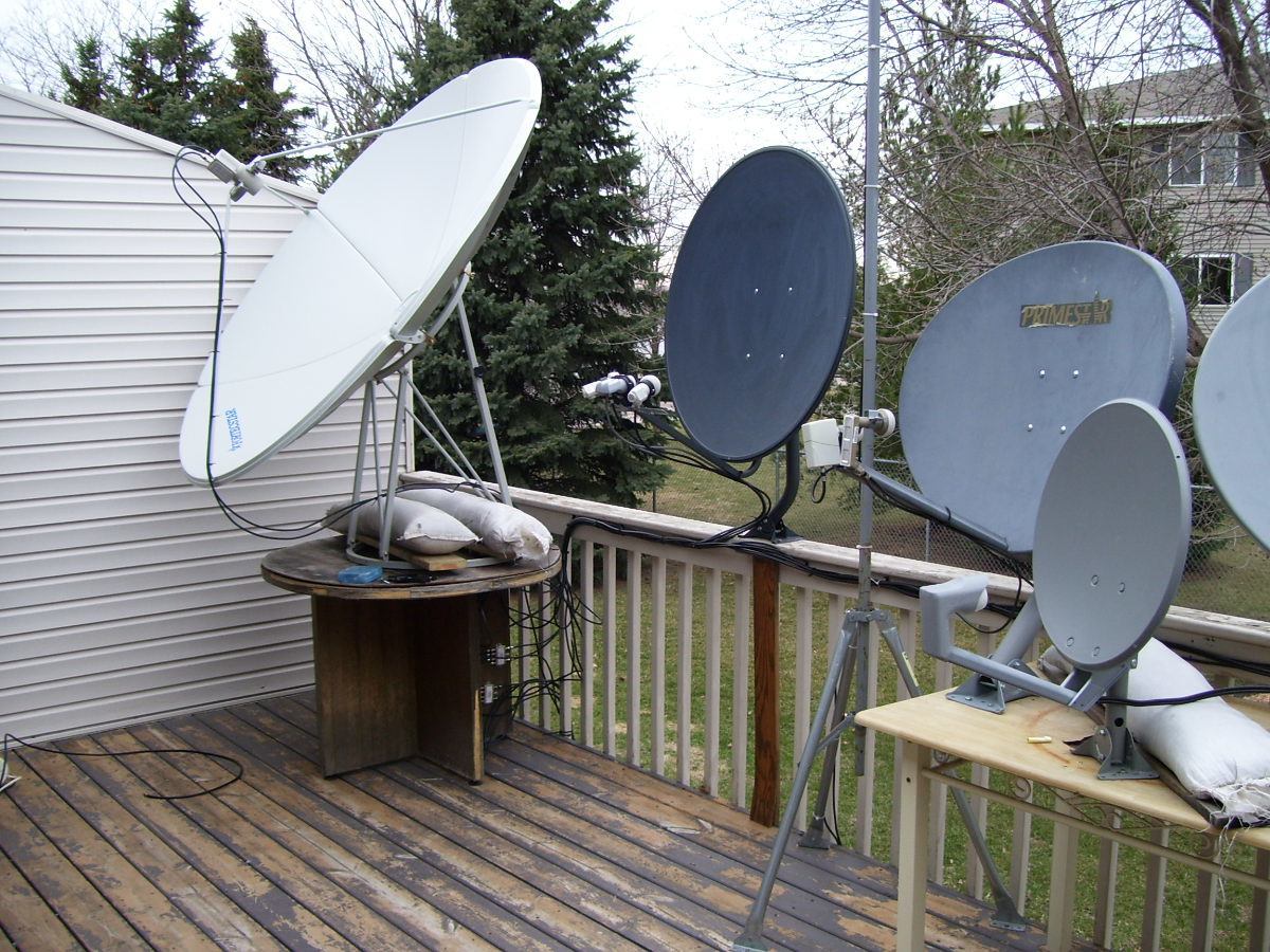

Here is a good example of an offset and a prime focus
The dish in the background (the 6 footer) is at G4 which is near my true south satellite (the satellite that is highest in the sky for me)...its at 38 degrees. See how it looks
now the grey one next to it is at 97/93. Its also at 38 degrees but since its offset it looks straight up and down. That dish is aimed directly at my house but the offset being higher the signal comes above it (basically off the roof)
