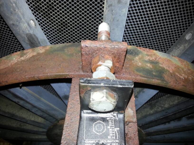

Are you talking about these bolts that pivot on the dish?
Sent from my SCH-I535 using Tapatalk
Let me see if I can describe the issue better. There's the collar that fits over the mounting pole. Then the large center frame pivots around the collar. That's what stuck. I should have checked that before taking the dish home. Does that help?
