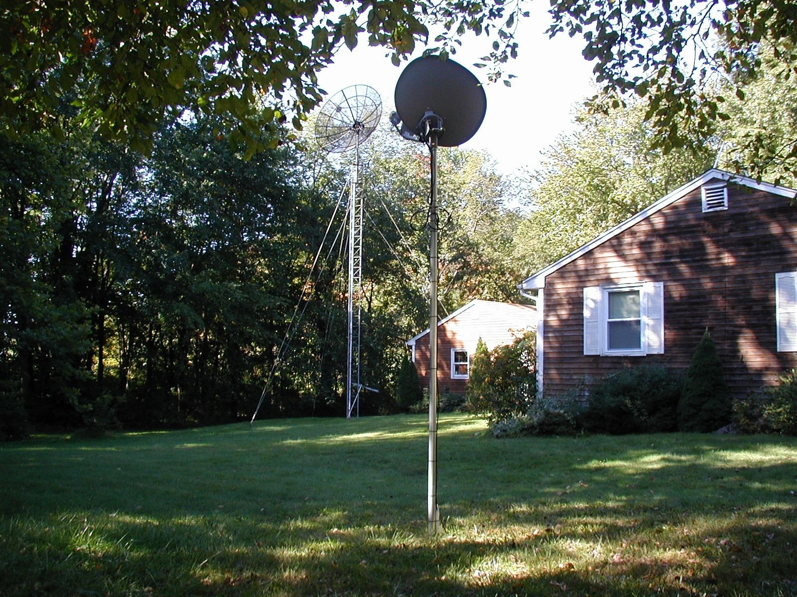

Why is it that you continue to refer to the new 5 lnb dishes as behemoths? You truly are clueless. Here is a picture of a behemoth dish with the sidecar 5 lnb in front of it.
That is a 10 foot dish on a 42 foot tower about 80 feet away.
