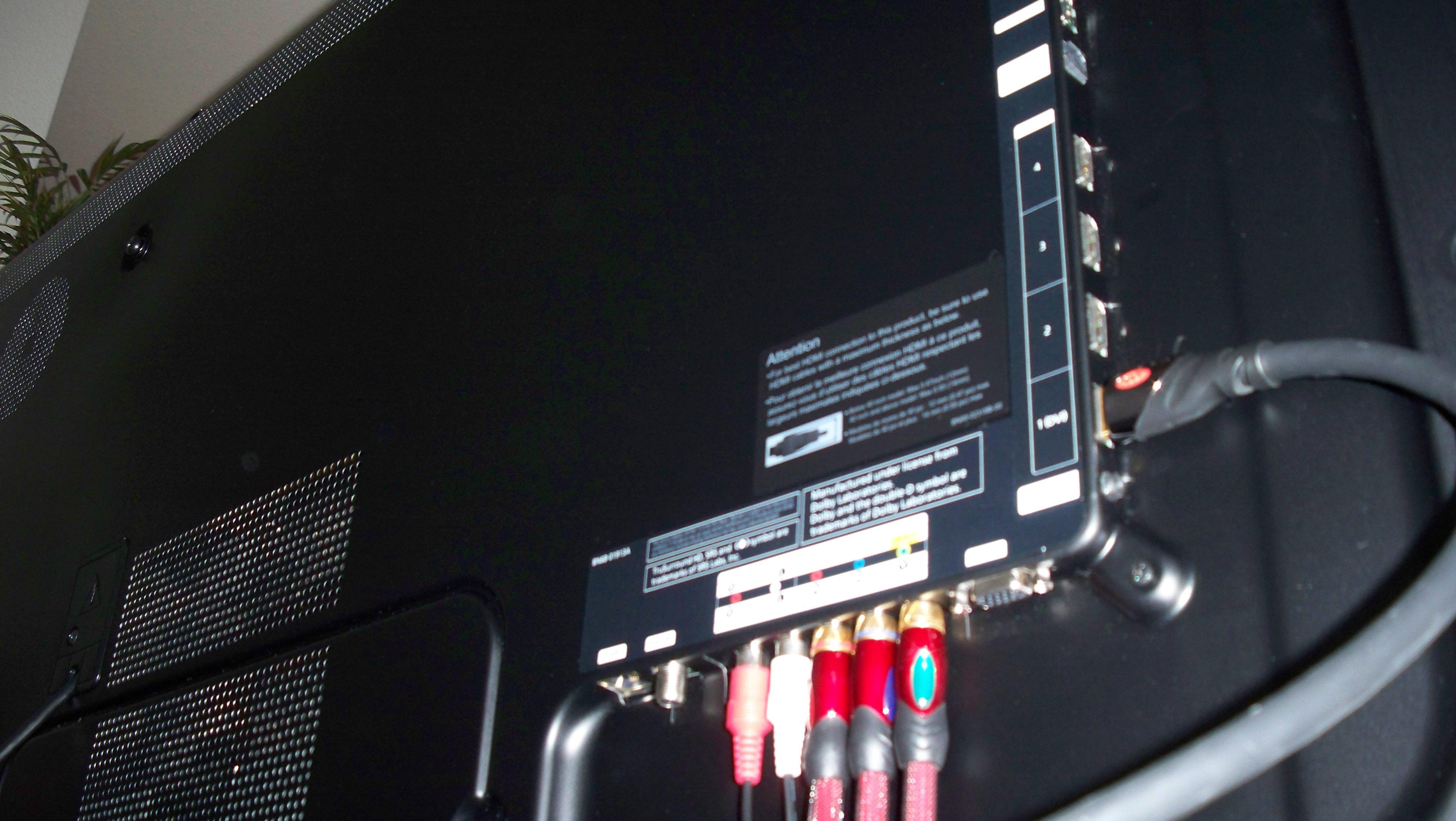

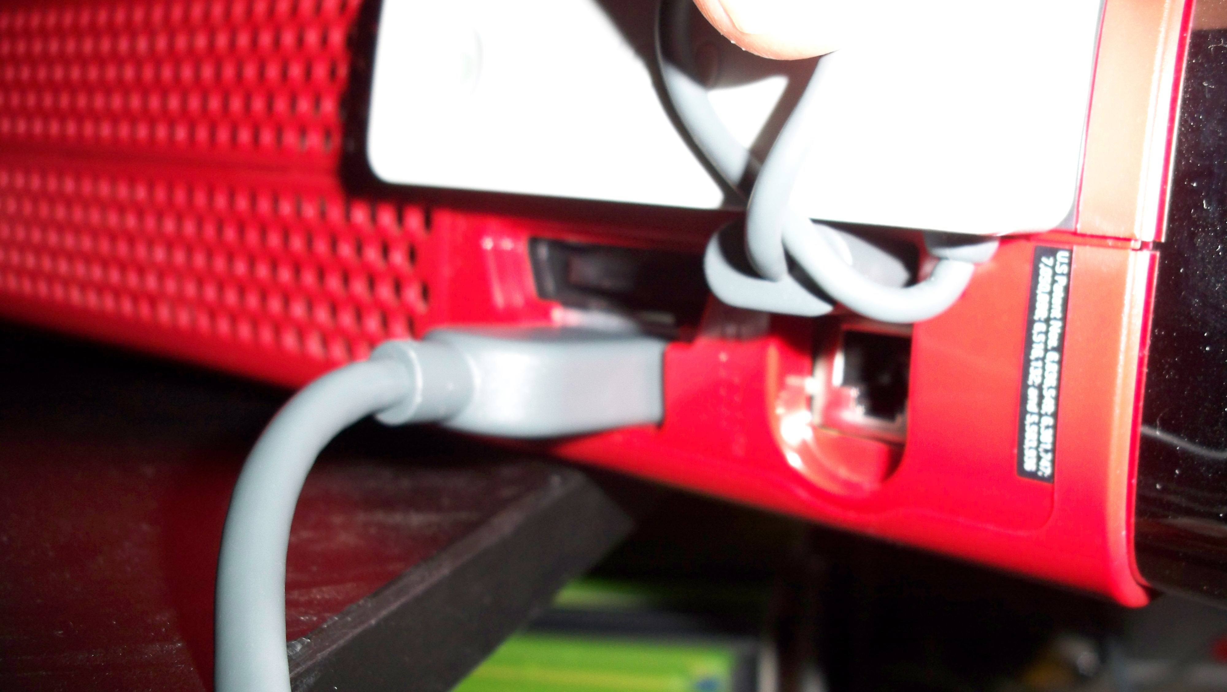

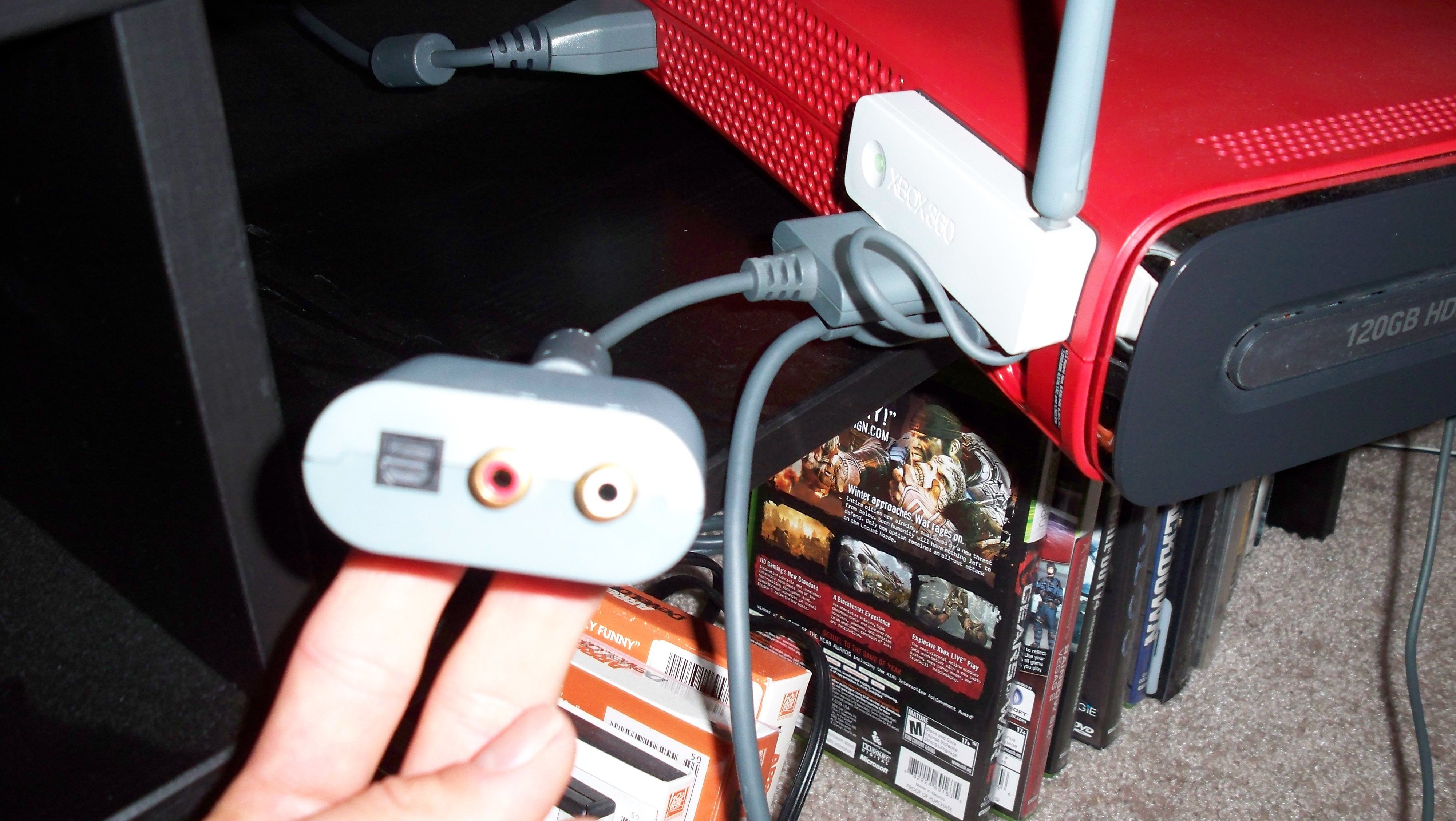

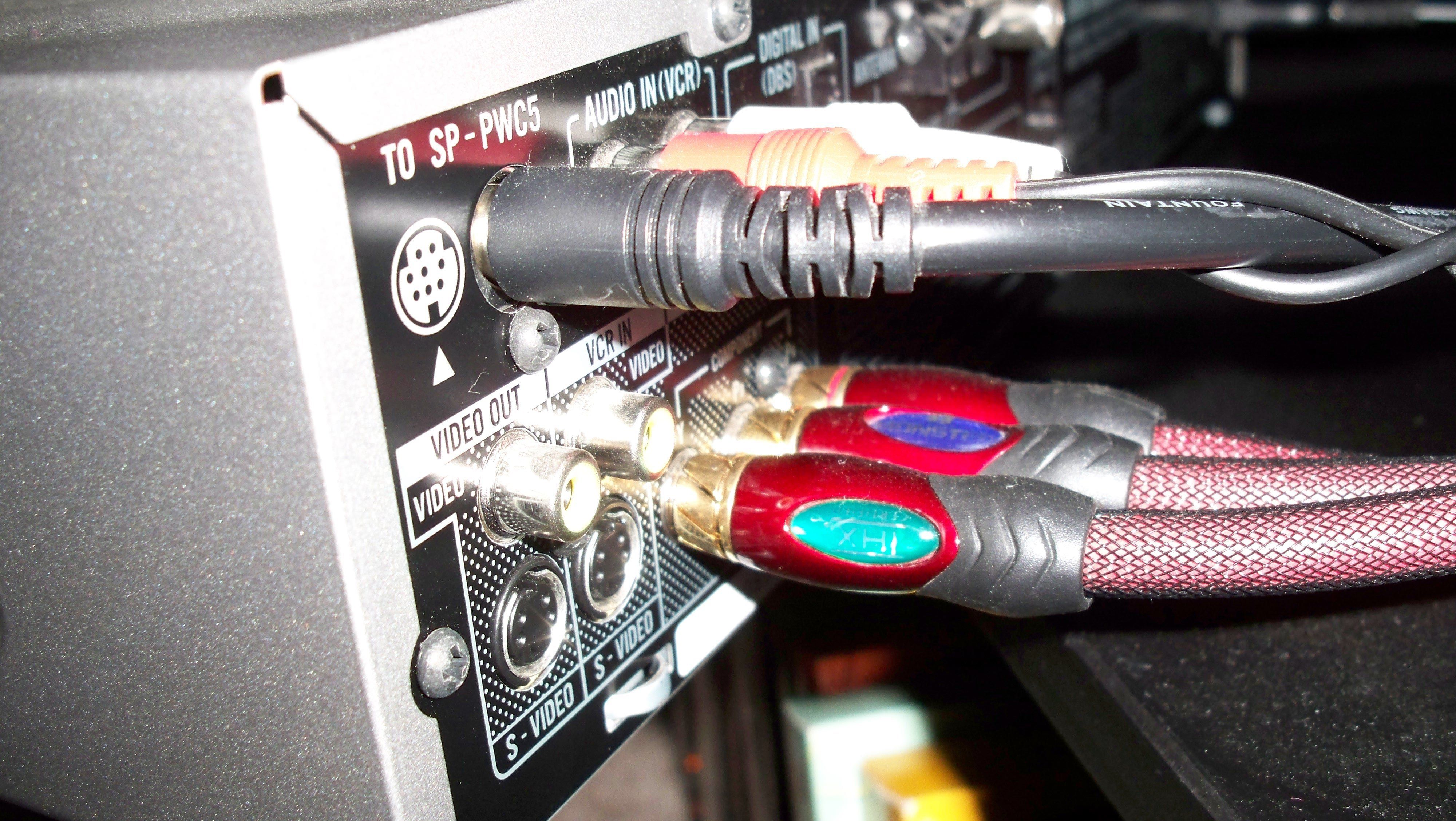

Here are some photos to see what it is I'm working with.
The first one is the TV.
The second is the back of the JVC DVD Player XV-THC5.
The third and fourth are of the Xbox. One picture shows the audio connection.

You just need to give your surround sound system a direct audio input from the Xbox to get the surround audio. The cable I mentioned earlier (make sure it's the right one) is less than $3 and not much more for shipping.
  • Buy this: Monoprice 12FT Optical Toslink Cable
  • Connect it to what you are holding in PIC#4 on one end (after removing the plastic dust caps)
  • Connect it to the input just to the right of the white RCA plug in PIC#3 on the other end.
  • Make sure both the Xbox and THC5 are using the digital audio setting
  • You should then have surround audio from your Xbox
The digital audio input of your JVC THC5 (seen on page 13 of your owners manual) is the best because you are already using the RCA connection. This is a very simple thing to try and hardly costs anything. Let us know what happens after you try those steps.
