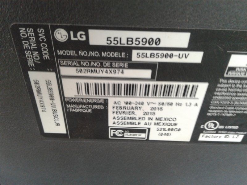

Here is the model of tv. For a better pic of the model number here it is. The power supply is on the back of the inside of the tv.
