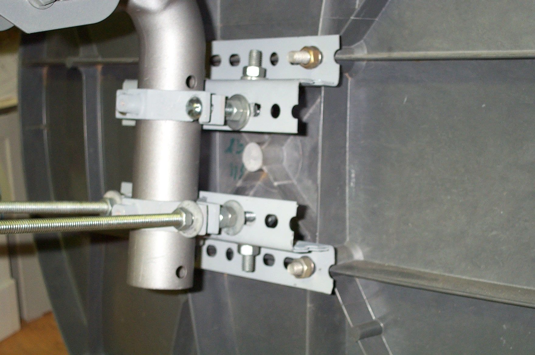

Here's one pic I saved, might be one of Anole's links..better way to do the job than using that heavy mount. The trick is to build in a way to adjust your declination offset-just bolting dish to motor will not give you the proper angle to track the satellite arc.

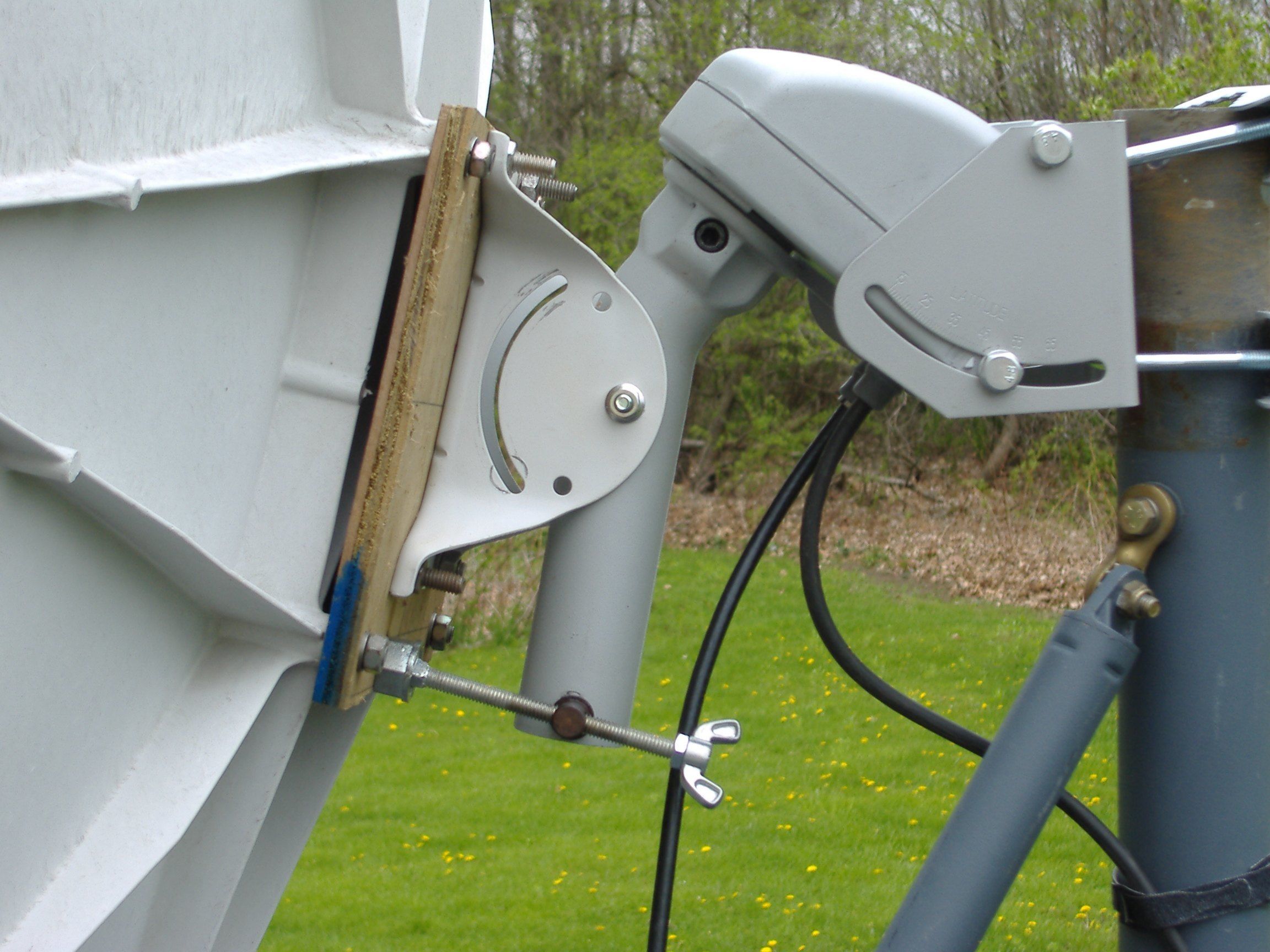

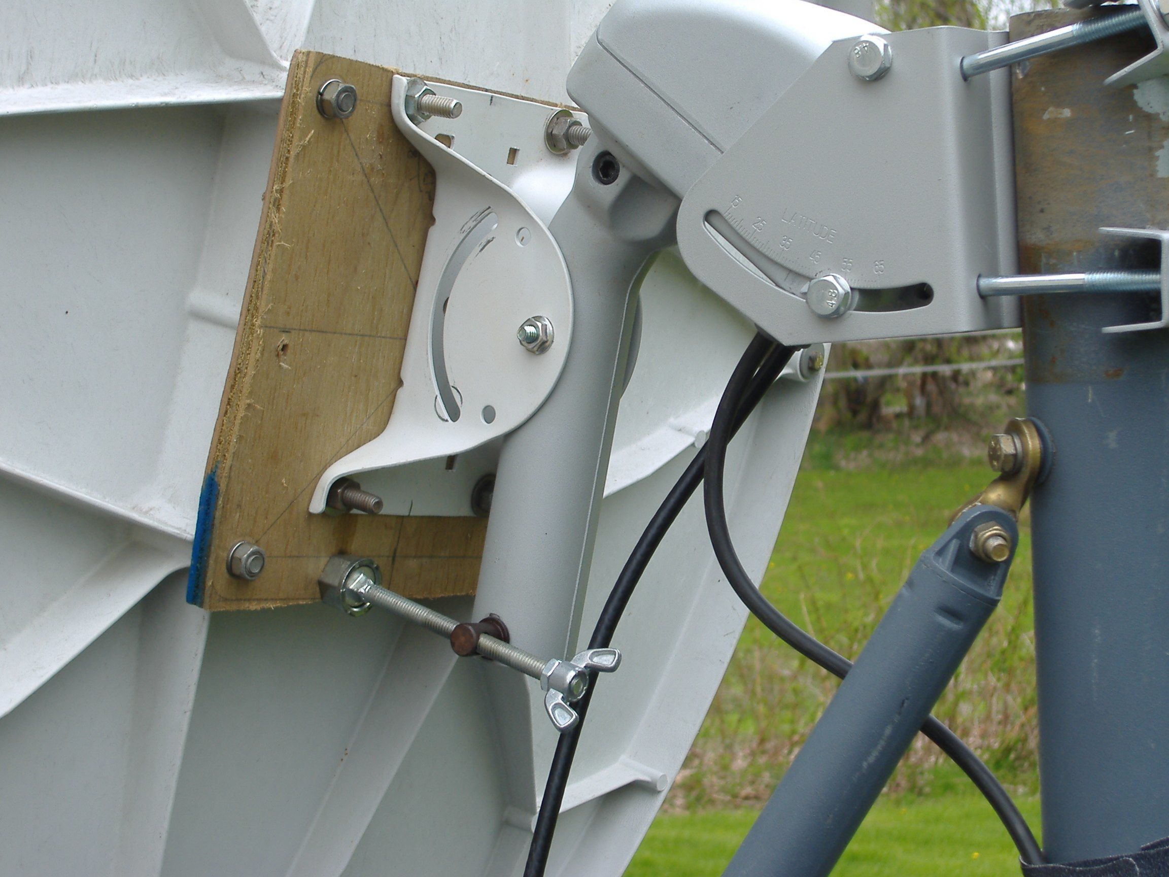

I've done exactly this with a DG 380. It's been working great for over a year. I bought a foot of clear flexible pvc tubing at the hardware store (probably 1.25" diameter) and cut pieces of it to shim the motor shaft.
While mine isn't an oval dish, it had the same heavy mount. Here are pics of what I did.
