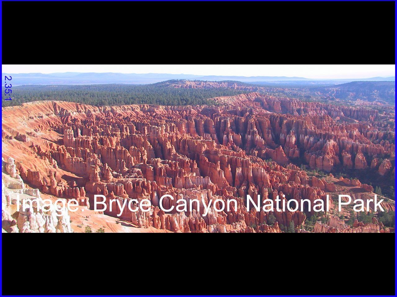

Hmmm, sounds like aspect ratio issues. Not all HD movies are a full 16x9 aspect ratio and will have letter-boxing of varying sizes, so this is NORMAL. OAR (original aspect ratio) is ALWAYS preferred by true home theater buffs. Resist the temptations to zoom, etc. Likewise programming that is native 4x3 will show pillar-boxing. Here is a decent read:
16:9 (wide-screen) TVs - CNET's quick guide to aspect ratio - HDTV World - CNET.com
Can you post a sample image; is yours like this?

My picture didn't look like that. Imagine the PIP option but much larger, but only filled 60-70% of the screen. Anyway, i watched the movie in 1080i and it was incredible. I watched an HD movie on some of the movie channels and broadcast and this was WAY better. It may not be full 1080p in my current situation, but dang I was impressed anyways. :)
