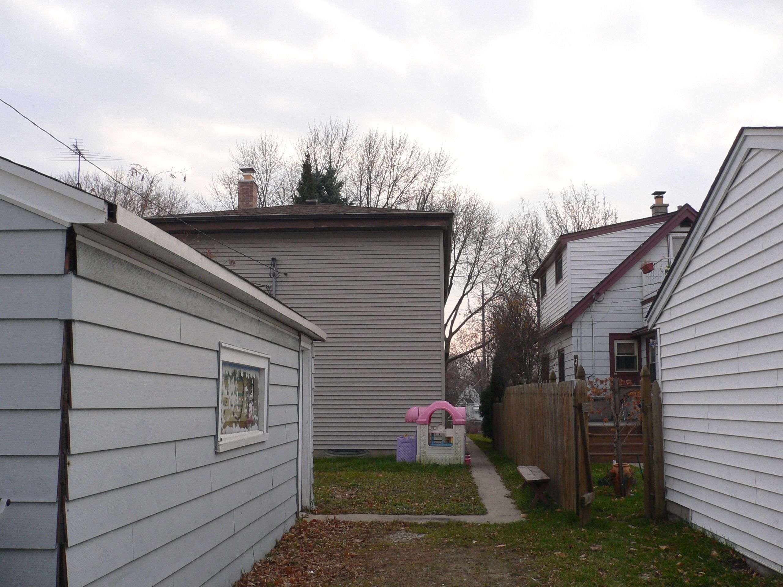

Very soon I will start to put all the hardware together…I have one more dish to play with my brother ordered a special Traxis DBS 3500 receiver and a Xtreme II LNBF 0.3dB and a Winegard DS2076 30" Dish which I have put together but need few item, I will ghetto move it for a while till I get everything working then I will permanently mount all the dishes I have, I think back of the house (facing true south) will be the best.

Actually I have not done much, since I missed the opportunity to install the dishes, so it makes no sense to do anything else till dishes are installed. I did not ordered the case yet, not sure I like the case, I need to order VMware Workstation 5.5, graphics card, hard drives, just to get the project started…so looks like spring…I do have hardware on hand to install the operating systems but hate to do it twice…and I do not have the dishes installed hence can't test anything…so might as well wait to get new hardware and do a single install…
