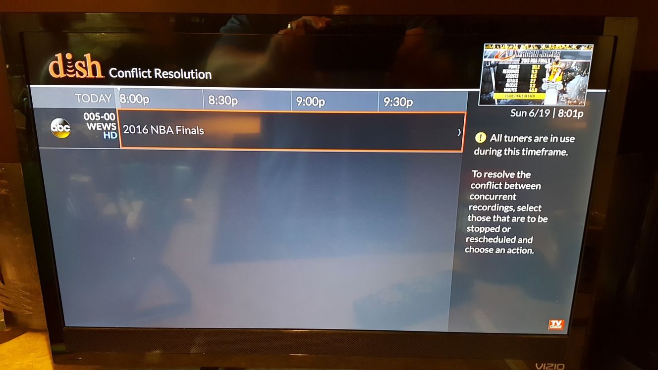

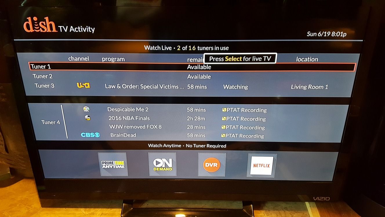

Kinda late to the party but I've had this problem several times and did grab some pics. The "conflict" pic shows the message displayed on the screen at 8:01PM and then the "tuners" pic shows only tuners 3 & 4 in use at 8:01PM. As I recall, rebooting the Hopper has addressed this when it has happened but it can be a PITA since the downtime means no recording.

I've seen that type of message on my I pad when I try to switch to a live channel . When you see that type of message it means it's time to reboot. Preferably a power cord reboot. Sometimes I do a status check and it shows me that some of the tuners or one of the tuners see 0 in satellite strength. So I end up doing a switch check then do a power cord reboot to fix that too.
