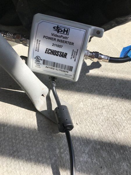

A week or 10 days ago I asked the forum if I can connect 119 separate and the rest of the LNB'S I was told that in order to use a hopper 3 instead of my regular hopper I would need to do the following which I did I have posted a picture of the setup which works great on the hopper but causing the hopper 3 tp say check witch will go on for hours without any progress.

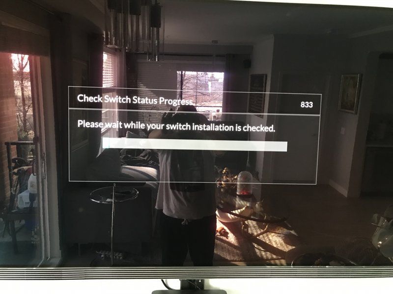

15DC8E6C-F318-4159-854A-2455F9B55918.jpeg Super dish if you scroll up you where one of the first people to answer my question. I can tell you 4th is the single dish I believe it's 119. I removed each wire from the 44 to the 42 got rid of the sole node. How ever my regular hopper works perfect. The hopper 3 is stuck on this screen for over 4 hours. I really need help I'm really frustrated.
No but you have the 119 into the 4th port, that's not where the 119 goes.

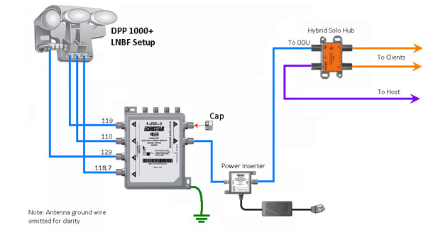

Here's the diagram you need to follow
Notice the order going into the switch - 119, 110, 129, <118, if you're using a DPP500+ International Dish>
