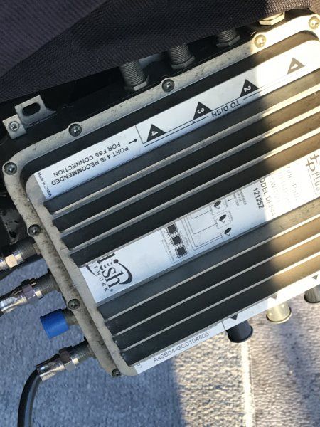

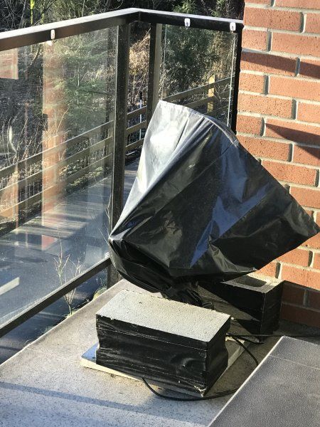

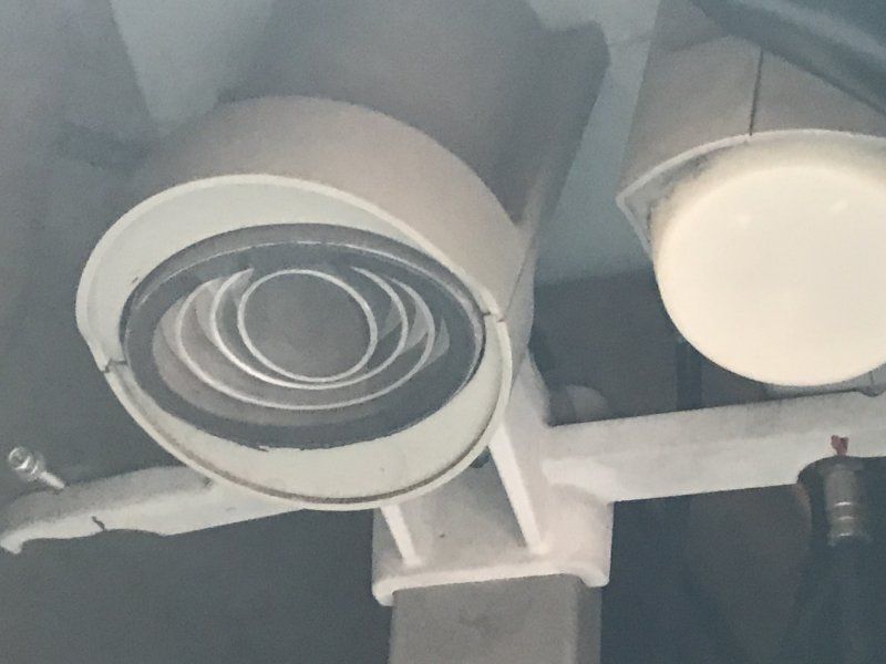

That's why the regular hopper works. However they are saying the hopper 3 will not be able to use both individual satellite dishes. The large dish has trees that are blocking the 129 signal that is why I have a smaller dish that clears the trees and able to do that. The reason why the dishes are concealed is because I live in a condo and strata will not allow it

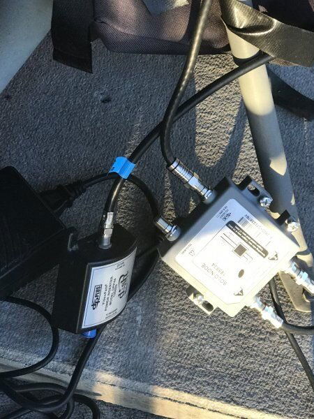

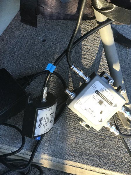

The Hopper 3 will work just fine with two dishes when you use a DPH42 switch. So, you would remove the 44 switch and replace it with the 42 switch. The coaxes fron your 2 dishes go to 42 switch. If you are using just one receiver, the Hopper 3, you can run a single coax from the 42 switch to the Hopper 3. If you are using Joeys, you need a solo node. Some of our installers will show you how it all wires.
If you have LOS to the eastern arc, you put up a hybrid, 1000.2 dish and use the 129 wing dish, cable ran to the input on the Hybrid eastern arc LNBF, the swap the solo node for a solo hub. I've done this before in areas where the HD locals are on the 129

He's in Portland, OR, he would be better off using the existing dishes with the 42 switch to bring hybrid into the picture.

No, DPH is Hybrid, which the Hopper 3 requires. DPP is not Hybrid. a 44 Switch is DPP, as is a Solo Node
A 42 switch converts a DPP dish setup to Hybrid, then you'd need a Hybrid Solo Hub in between the 42 Switch and the Hopper 3
He's using wireless Joeys. I think there is no need for a solo hub in his configuration. He can go directly for the 42 switch to the Hopper 3.
