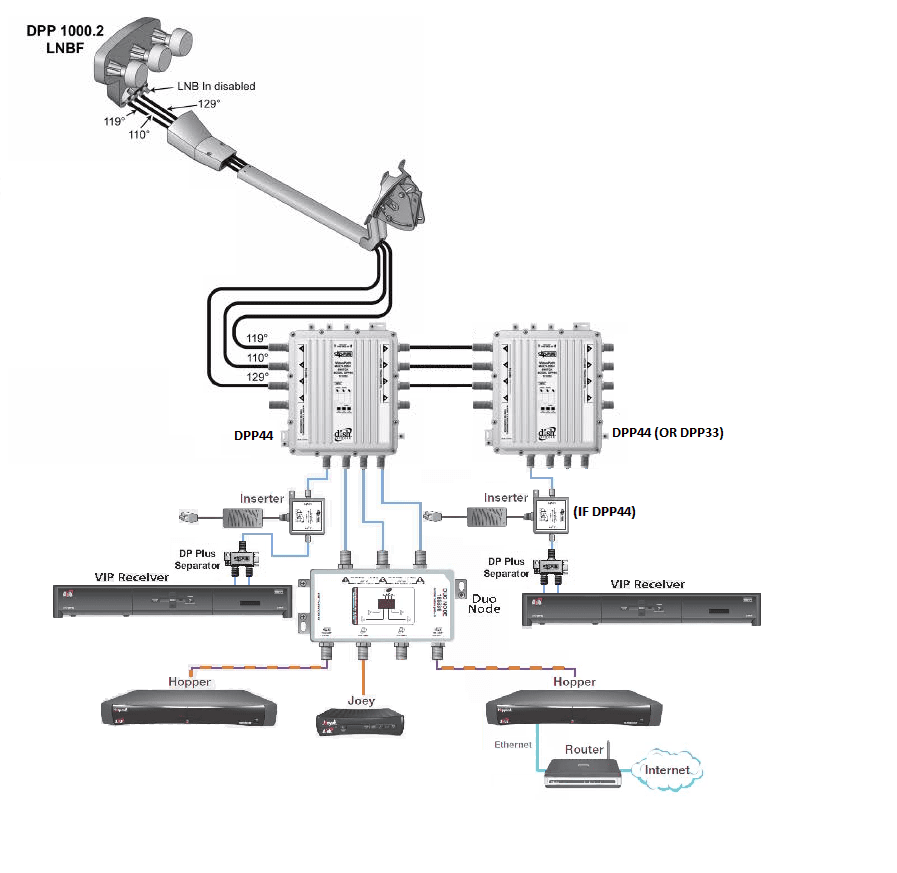

I claim it is possible (via two accounts) to put 1 Hopper and 2 612's on one DPP44. With two Hoppers, you need 3 DPP outputs which could be done with two DPP44s or (theoretically) one DPP44 and one DPP33 cascaded off the DPP44.
Yeah I would want 2 hoppers eventually. 1 hopper/joey and 2 ViPs could get away with a single DPP44 and a Solo Node. Here's what I want:
Should work, but damn Dish! I hope they don't keep their stupid rules forever...
EDIT: Revised diagram.

My guess is that the cheapest way to go would be to add a DPP33. The Hopper solo node needs 2 DPP antenna inputs, while the dual node requires all 3, so theoretically this should work. The installation diagrams in this thread show a DPP44 switch working, so that would be the high-priced way to go.

You will need a DPP44 or a DPP33.

Supposedly OTA tuners are coming, but won't be supported at release. The 3 feeds are to feed the dual node and 2 Hoppers. One Hopper can get by with a solo node and 2 DPP switch feeds.
Two coax for single. Three for dual node. So when you go to 6 tuners, you need 3 coax.
