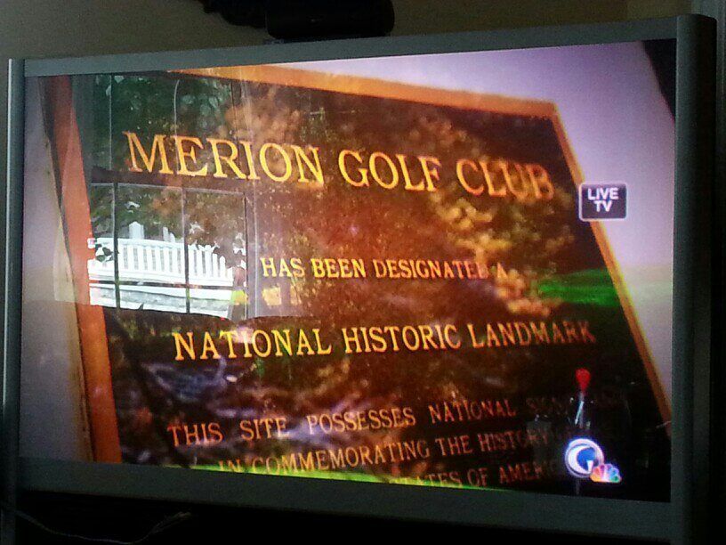

Anyone hit the "View Live TV" button and seen the graphic not go away ? Did it a bit ago and it's still on my screen. I'm sure if I change channels, turn on guide, etc it will go away.
Attached a picture and will note the time in a minute... Taken at 12:45 and it is 12:53 now and still there.

Just checked, mine goes away quickly.

I had that happen once. Went away after I paused/pressed view live again. Pullinh up the guide would just put the icon in the preview square, then when i exited it was right back. However the pause then view live tv thing worked. Haven't seen that glitch since that one time.
