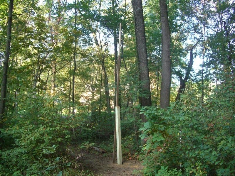

Would this be a bad idea? I already bought a 12' 6x6, I was thinking I could bury 6' of it and bolt the other half to the bottom of the pole to give me more height. Of course I would have to have the pole attached when I set the concrete.
In the attached picture, the 2x4's are 21'

Wood warps and twists, you need the pole to stay steady. In my opinion if you dug a hole at least 18" square by 4' deep, and widened the bottom of the hole by about 3-4 inches all around that should be enough to support your pole. A regular post hole digger can do that. Once you set the pole in the hole you must brace it in every direction and make certain it's plumb all around. Pour the concrete and tamp it down every few inches so it spreads into the undercut at the bottom of the hole. Bring the concrete up a bit above the ground surface and arch the top so rainwater will run away from the pole. Let it set for about 2 days, remove the bracing and your ready for the dish. If the pole isn't steady enough, flexes, or isn't plumb you may have to add guy wires to it.
Now, how are you planning on getting the dish up there (17 feet) and then tuned in?
Attach rebar or place bolts through the post before setting into the cement. This will prevent the pole from spinning.
Do not attempt to use the wood. You will regret it!
