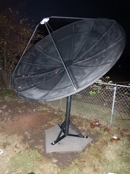

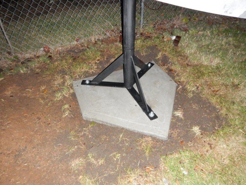

Attached are a couple of photos of the pipe mount on my current setup. It's mounted to a slab with piers under each bolt location that go down 3' to bedrock, rebar in slab and piers. The dish in the photo is a 7.5' dish, later swapped for a 10'.
The tripod allows adjustment for plumb and if/when we move to another house, I just have to unbolt and load it up.
I like the look of that. I just don't know if I could make a base like that and get the bolts in the correct position. Then find a pole that could be bolted down cause I'm no welder lol.
Sent from my iPad using the SatelliteGuys app!
Here is a really slick pole mount by Fred555 that allows adjustment for plumb:
http://www.satelliteguys.us/xen/posts/4011447/
In my case, the pole was already welded up like that. The digging and setting forms for the base was the easy part. Mixing up all the concrete in a wheelbarrow was the hard part.
If you have the pole, a welding shop should be able to attach a couple of legs for cheap. The bolts went in after I placed the concrete for the slab/piers. There's a drawing with measurements for the mount here
Once the concrete had cured for about a week, set the dish mount onto the pad. Marked the dish mount holes, then used a masonry drill bit to drill down through pad into the pier about 12-inches, blew out the freshly drilled holes and then used concrete epoxy to secure threaded rod into the holes drilled in the concrete.
Hindsight... Probably should've made a template from wood or plywood to mount J or L-bolts and then set the template with bolts into place while concrete was wet. Would've been cheaper than the concrete epoxy and threaded rod (i.e., not all-thread).

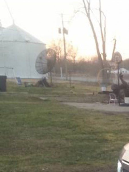

Stopped by and left another note on the door of the house I seen with a 10ft. Got a couple of pictures that was closer but still didn't want to go in the yard. Good way to get shot at.

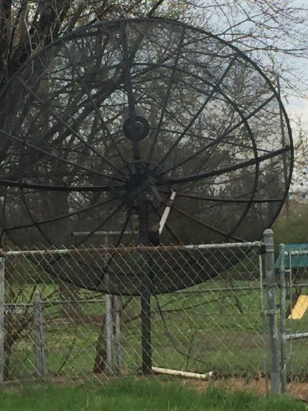

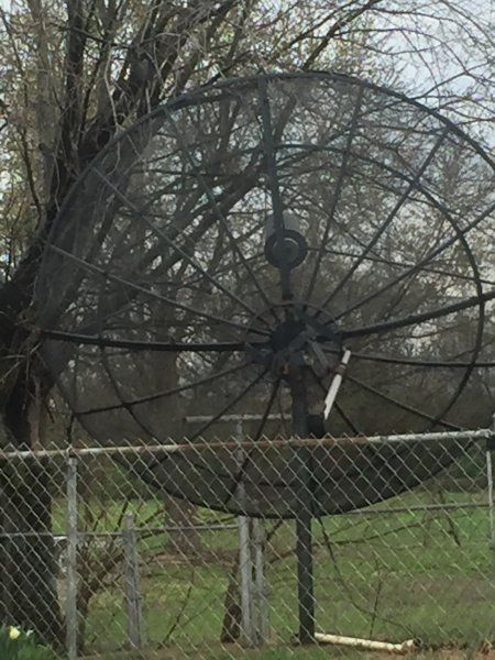

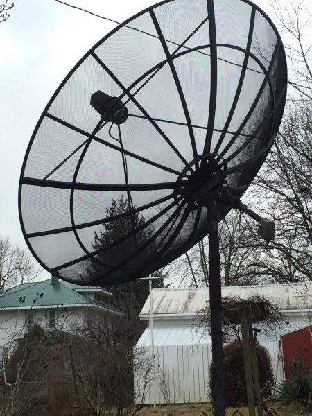

Here's an update. Never heard back from the people I left the note for but I have a buddy of mine asking his grandpa if he wants to get rid of his dish which I think it was a 10ft. It was in good condition when I seen it last and had a new actuator put on before they moved across the street and quit using it. It looks like a dish I got a picture of when I was driving around. The other picture is of the dish but not a good one. Hope to get some better pictures later.

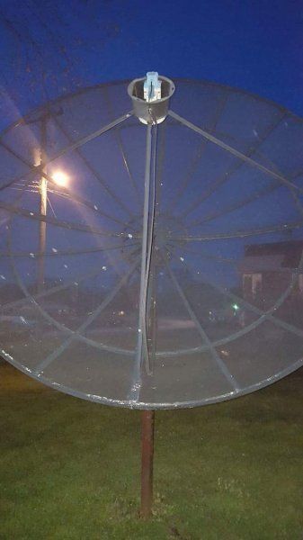

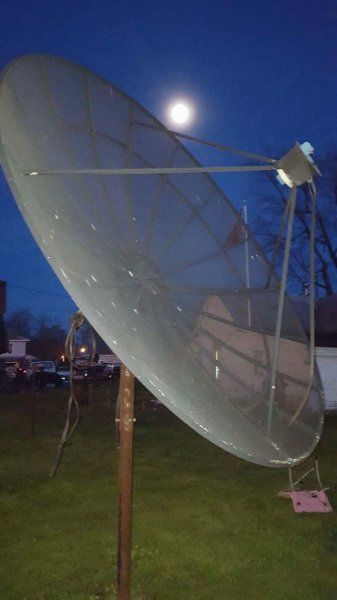

Well my buddy's grandpa gave a drunkin yes to the dish but he'll get a sober answer tomorrow. Here's a few pics he sent me.

Looks like a 10 footer. Don't worry about the nose cone. They are great areas for wasps to fine a home. 3 or the 3 dishes I have taken down have them.
Run your dishes naked. Makes them much easier to tune out on the fly.
