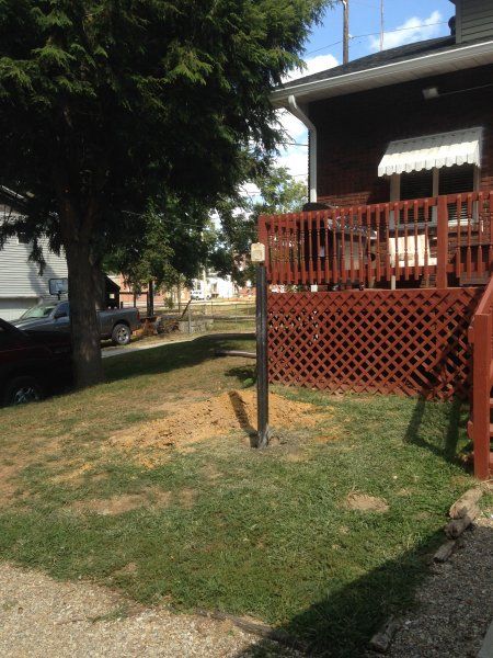

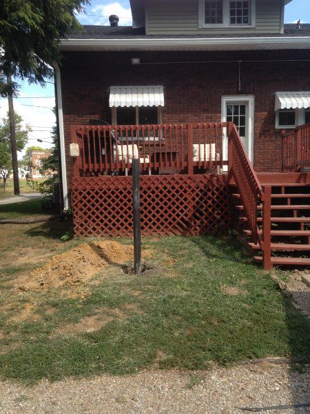

Got the pole finally installed today. Ready to have this up and running

How long should I let it cure before putting the mount on it? I've seen anywhere from 24 hour to a week. Also what grease should I use on the actuator?

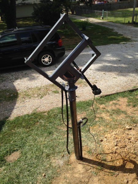

Little more progress today. Got the mount on the pole and painted. Removed the old actuator and started to put the new one one when I realized the pivots are frozen up so I need to spray them to loosen them up and get a new bolt to mount it since the old one and a different setup.

Any advice on freeing the pivots? I've soaked them in a rust remover and took a Dremel to it and sanded it the best I can and there both not budging
I've been soaking it in PB Blaster for a day now and both pivots still not moving so looks like I'm at a stand still again until I can free them up or somehow find another actuator.
Are you referencing the mount pivots points or the ball joints on the actuator? If on the actuator, buy a new one from Venture or Von Weise if the ball joints don't freely rotate after a few days soaking.
