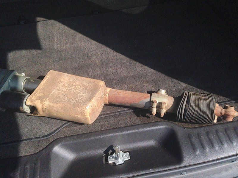

Got the dish on the mount. Talk about pain in the ass fighting that thing. Got my hands on another actuator problem with this one the pivots move great but the tube isn't seized up. Any why to break it free so I can try and use it?

First thing I would do, is try and remove the MOTOR from the tube. Then, use a channel-locks, or maybe a deep socket wrench, and see if you can turn the actuator screw at all that way. If you CAN'T do it either way, you might be able to run PB Blaster down the actuator screw, and get it to loosen up. Once you can get it loose, you probably will need to replace the grease in it. We can take that up later if it gets to that.
I already took the tube off the motor and knocked what looked like dirt out of it. I didn't see where I would stuck a socket on it. I tried vice scrips on the extension tube to try and turn it but it wouldn't budge. I sprayed pb blasted on the extension seem and on the bottom where the motor attaches before I left for work.
Ok, soak it good, and lean it up somewhere so it can run down the tube as far as possible.
After soaking it all weekend it's still not moving so back to searching around again.
Do you know anybody with a large enough well anchored vise? If so, clamp the remaining part of the pole in that. Then maybe you can work another long piece of pipe into the mount in a way that allows you to try "unscrewing" it from the mount pipe. If no vise access, drill a couple holes in the pipe piece, and use some lag bolts to bolt it to something made of wood and strong. Then try to unscrew it.

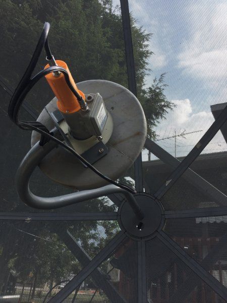

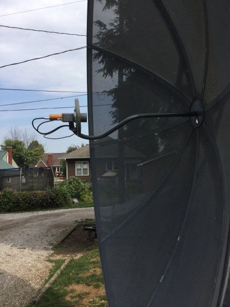

I put the LNBF on today found I have a few more hurtles to overcome. The button hook is seized up so the scalar ring is at 34 inchs from the dish and looks like I need to be 33 5/16 inchs away and the LNBF need to be set at 28 but the lines only go to 32. I'm going to half to take everything off to set it cause the buttonhook mount is blocking one of the tightening screws.

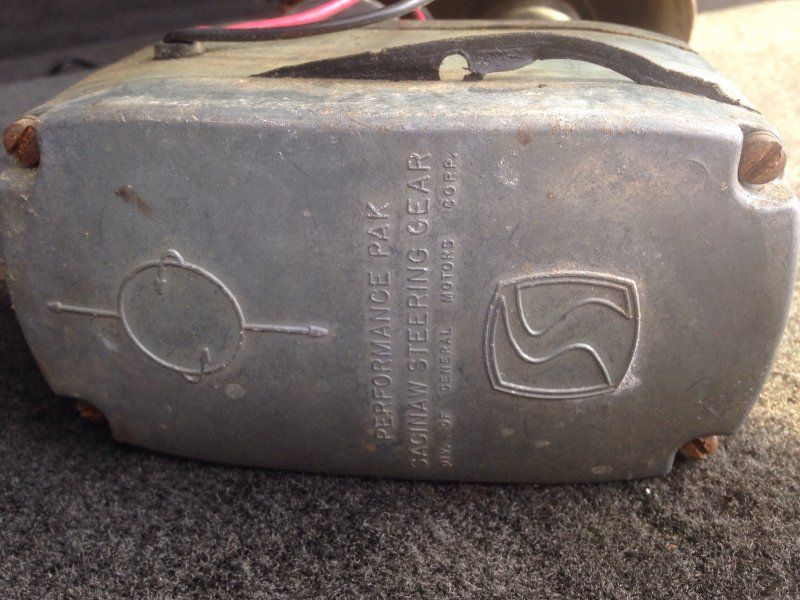

The brand on the bottom of the motor

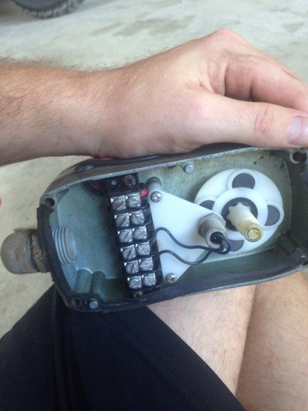

I'm guessing this is an optical sensor
