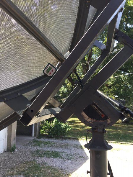

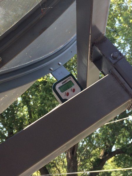

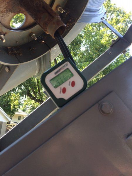

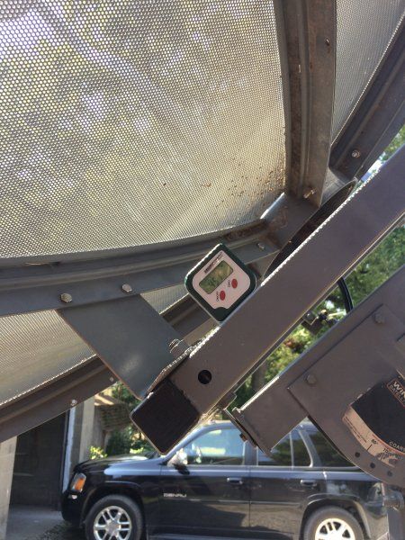

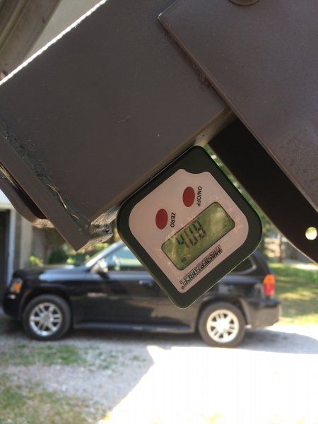

By the looks of it my numbers are way off. I need to figure out where to put the meter so I can get accurate numbers because it changes every time I move up or down the mount.
Set my elevation to 38.2 and declination to 44.3 and still not getting a lock on anything. I'll try again tomorrow since it's time for me to head to work

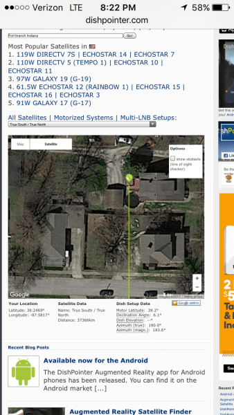

This is what dishpointer it's tell me how to set up unless I'm reading it wrong. My location is fort branch Indiana
Well, your scale is called 'coarse latitude', so it is correct to set that to about 38.2.
The 'elevation' then is (90-38.2=) 51.8, however.
(Terminology IS important! :) Or you will confuse us...)

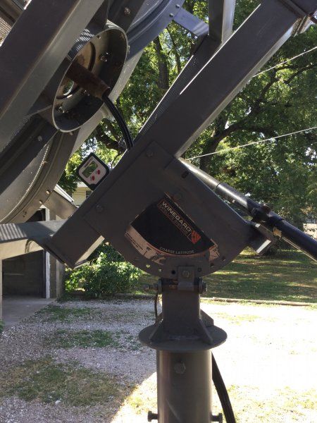

I cannot understand from your photos how you set 'fine latitude' with your mount, though.
Do I understand right that you set fine latitude together with dish declination?
Why not measure final dish-angle at the face of the dish (with a wooden plank or so)?
Elevation of total mount+dish should be 51.8 - 6.1 = 45.7 degrees (0 degrees = towards horizon; 90 degrees = towards sky.)

From your pictures I would assume that your mount elevation is now about 41 degrees (towards vertical, I would guess).

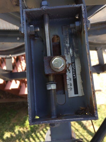

How is the fineadjustment for this mount-elevation constructed? Is it with both the two bolts, visible in the right/under quadrant of your picture 1494.jpg?
Edit: Or is it below the coarse setting bolt, just UNDER the picture 1485.jpg?
I don't know if you can adjust below the coarse setting of 40 degrees latitude. If not, you have to set the coarse setting at 30 degrees, and add the 8.2 degrees in the fine setting.

Picture 1487 shows declination adjustment. It should be set to your latitude which is 38.2 deg. Once set your dish "should" be in the ballpark if the markings are accurate on the decals.
I've read the manuals and I'm still confused on setting this thing. Doesn't make matters better that the mount is very hard to adjust, even the manual on this forum for the dish shows a different fine adjustment elevation bolt. I readjusted the dish to 45.7 elevation and with the 6.1 declination I'm getting 51.8 on my inclinometer when on put it on the back of the buttonhook plate on the dish. I'm still not receiving anything and yes my pole is plum. I need to get this thing working soon before it has to come down and taken to the dump.

How do I set the declination on this thing? All I seem to be doing is bending the sh*t out of the bolt

Now that your fine-latitude bolt is better visible on your photo, it can be seen that you probably will not reach 38lat/51elev with the fine adjustment.
So set the coarse latitude to 30 (I mentioned earlier that that would probably be needed), and then fineadjust to 38lat/51elev.
Don't set it to 50, as you mention, as the scale is in Latitude!, so you must use 30.
You don't touch it, before the mount's axis angle is absolutely right! :rolleyes::rolleyes::rolleyes::rolleyes::rolleyes::rolleyes::rolleyes::rolleyes::rolleyes:
After that, you wait a bit. You got to do this step by step.
After that, you loosen the top (axis-) bolt first i guess?
