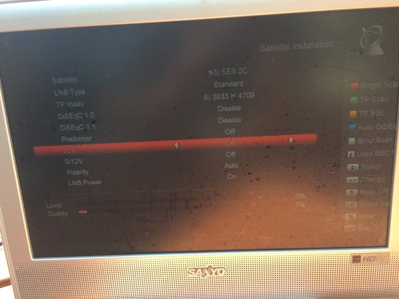

It's hard to see but this what I have set on the receiver when I'm trying to find 87w
Go UP to the LNB setting, and change it to "5150" and save it.
Change the transponder settings to: 4140 V 29125 3/4 FEC
That's the Luken transponder. You get that in, and you'll be good.

I don't know for sure with that specific receiver, HOWEVER, the lnb is 5150 LO on the c-band side for sure. Setting it to 5150 is one less "unknown" you will be dealing with.

I agree with Primestar31, set the lnbf Lo to 5150 instead of standard. Are you positive that you're connected to the C side of the lnbf and not the Ku?

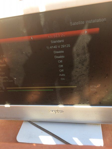

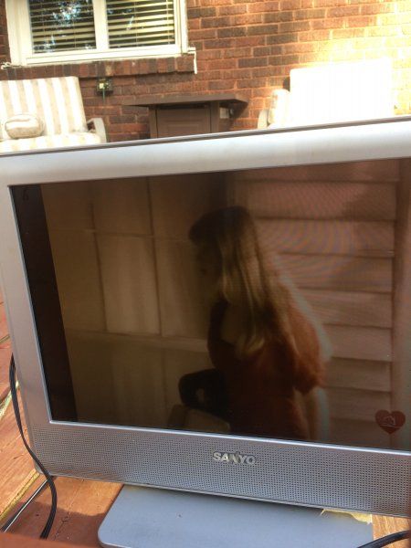

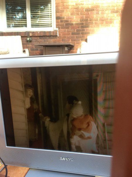

I finally got a lock. I put the original lnb back on and had a lock within seconds. I'm getting a L86 and Q67
Kept adjusting if that's the best I can get.

That's awesome! Now, don't play around with it right now. Just enjoy a little of the programming on that sat for tonight. Tomorrow, you can move the dish East and West and see how other sats lock as you move across the arc. You'll want to make SURE the very top of the arc is at your mounts true South, and Declination is properly set, BEFORE you do much else.
Show your partner what you have accomplished for now, and see how that goes over...

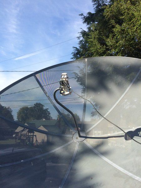

A buttonhook feedhorn support is much easier to align then using three or four point support arms. There is no reason to replace a buttonhook with three or four point support arms as long as the buttonhook is mechanically sound. I have added steel ropes with turnbuckles to center a buttonhook and would favor that over replacing with rigid support arms.
Make sure that the feedhorn is centered on the reflector. Take measurements from three or four points on the dish edge to the exact middle of the feedhorn. These measurements must match. If the measurements are not the same, the feedhorn is not centered on the reflector. Any movement of the reflector and the reflected signal will not be tracking the arc even if your reflector is.

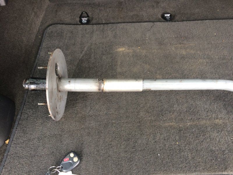

The problem is I can't adjusted it because its seized up and I need to slide it way from the dish more and I've tried everything to get it to break free except for a blowtorch and that's because I don't have one
Cut it off with a hacksaw at the middle of the stalk, or wherever would seem to work for the following. Sleeve the original tube with a slightly larger tube/pipe/E.M.T. over the top. So, the new piece of tube will connect the smaller sawed original pieces as they will fit INSIDE of it, like an telescoping old-school radio antenna. This new piece of larger tube, can have 4 slots hacksawed on each end deep enough so that you can use a U-bolt clamp to squeeze it to hold it for adjustment. Once you KNOW you have it where it should stay (everything tuned in), you can drill holes through and bolt it all together if need be.
