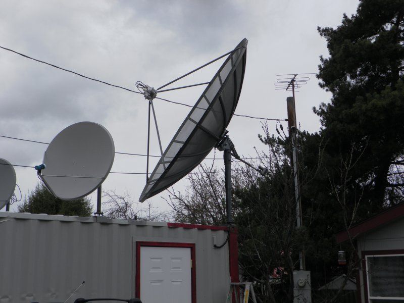

Mine was branded "Laser" but I think it was sold under other names also. LaserCKU 002.JPG
This one had been converted from button hook to quad leg.

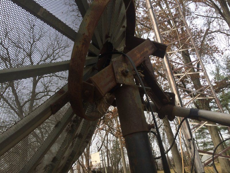

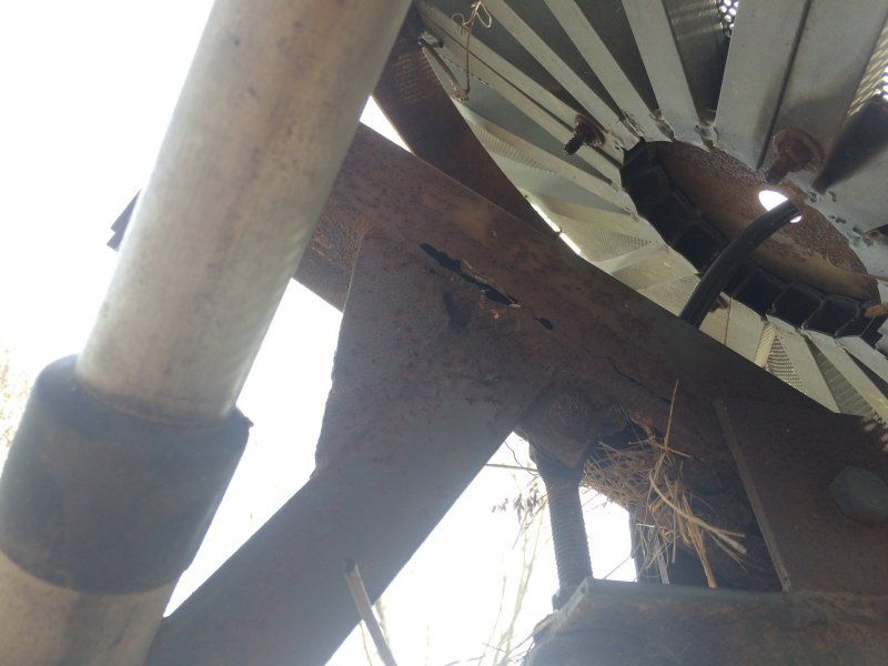

My main concern with this dish is there a rusted out spot on the mount that you can see on the third picture. Should I be worried about this?
I'd weld/have someone weld a patch over that because eventually it may rot more and then break.
It's hard to tell in that picture, but it looks like it could maybe be patched up with a piece of angle iron. The last dish I picked up had a couple of spots like that and I cut out the rot, then used angle iron to patch it up.

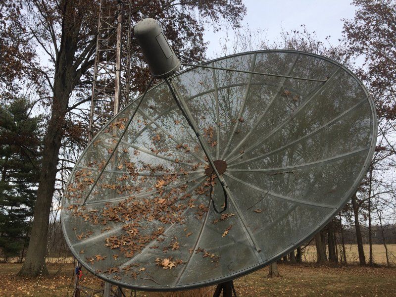

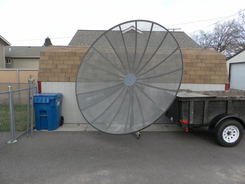

I'm going to be getting this dish in a few days. Think it might be a winegard quadstar
I don't think that's a Quadstar. I have a Quadstar and the feed arms attach to the outer edge of the reflector. Also on the Quadstar the mesh is crimped on the outer edge (which makes it hard to take out a section).
Looks like you got a good reflector, but that the mount has seen better days. I also think that it would be good to patch those bad spots. Better safe than sorry.
Glad you have located a replacement. Agree with everyone on patching the mount. Would certainly figure on adding in some form of alarm, Bright and Very Very Loud when tripped. Would also consider some video of it as well, that way if someone tried again, even if they ran from the alarm, the pictures would help the LEOs.
The pivot arms used to let the dish move across the arc appear to be welded off center on the mounting ring, the dish is painted grey, and the hood looks exactly like the ones Perfect 10 used. As far as I know, Perfect 10 was the only dish manufacturer to weld these brackets off center. It is very possible you have a Perfect 10, but it's also possible you have a Winegard.
If it's a Perfect 10, they were one of our favorite dishes, but I can't be certain without a straight on shot of the dish from behind. In any case, it's a great find. :)

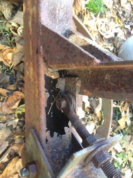

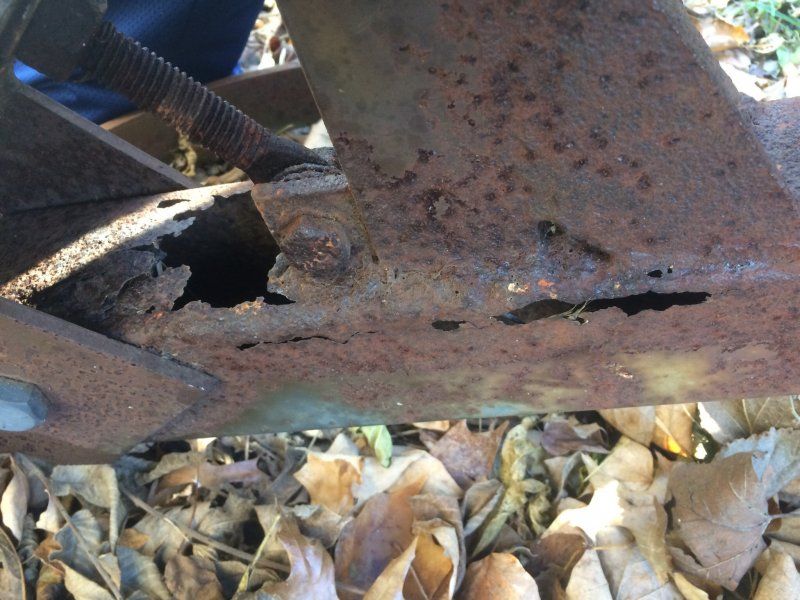

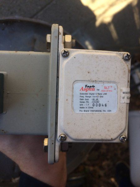

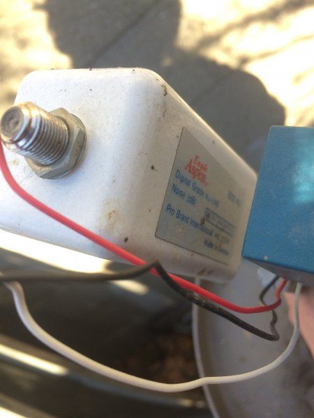

The old man that had the dish helped me take it down so it took about an hour so that was great. Most of the bolts broke so I'll half to find new ones. Here's some pictures of the lnb which is c and ku band so that was a nice surprise and the rusted mount. I'll need to make an adapter for my pole to make it 4 OD to 3.5 OD.

Looking at that mount, I think I would take to a welding/machine shop and get them to build you new one. Just the rusted out part, not the whole thing. The real important part is the holes on top and bottom are straight and aligned well one to the other. Won't be real cheap, but I don't thing it will much longer. I am guessing, but would bet that other parts of it are getting pretty thin as well.

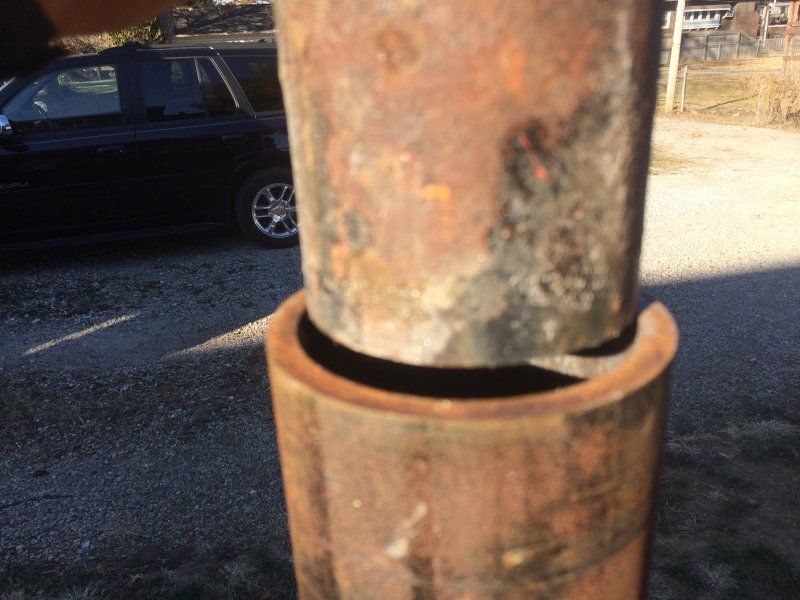

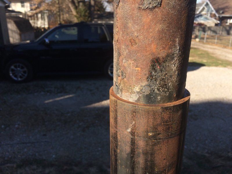

So I got the the pole that fits the mount problem is my original 4OD pole opening is 3 3/8 not 3 1/2 like I thought so how should I go about getting this to fit?
