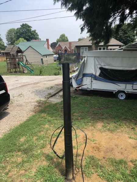

So I got the the pole that fits the mount problem is my original 4OD pole opening is 3 3/8 not 3 1/2 like I thought so how should I go about getting this to fit?
If that's a piece of schedule 40 4" OD, it should be 3 1/2 inside. Looking at the picture it look as if it was cut with a tubing cutter. If it was, you may want to look close at the inside edge of the 4". A tubing cutter will roll an edge on the inside of the opening that would stop the 3 1/2 from going inside it. I have taken 4" OD schedule 40 and drove a piece of 3 1/2 inside it many times. It takes a clean surface, patients, and sometimes a little grease, but it will go inside it.
Then you can clean off the grease and weld it or drill through both and put a bolt through both to keep it from turning inside the 4". Both pieces look like schedule 40. Just a suggestion.

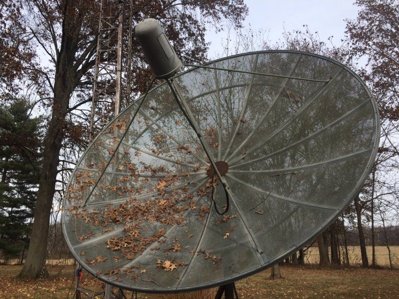

I was drive home from Illinois and seen a fiberglass dish but what caught my attention was that it has a ajak motor on it. How hard would it be to put a different dish in the mount? I already have a 10ft mesh dish behind my garage but the mount is severely rusted and I've been waiting on my mechanic to get around to fix it. Since I seen this I didn't know if it would be worth the effort or not.
Never had an AJAK myself but if it were me and one was available I would get it. I've seen many threads here of people adapting mounts to other dishes. Should be just a matter of obtaining/making brackets to connect the two properly.
An AJAK is an awesome mount :) I have two of them. It would be easy to adapt to a mesh dish. If you grab that mount make sure you get the dish ring with it. It will have the declination adjustments with the ring. I've seen two different styles of the ring on the H180 mount.

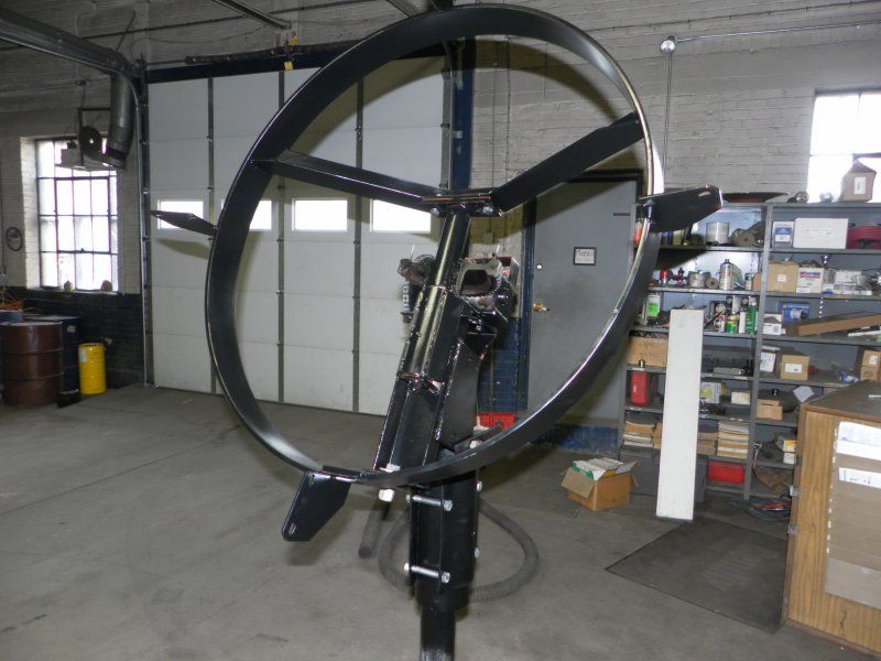

So finally I getting time to start this again. Got the new pole into the original one to put the mount on it just need to put a bolt threw it to hold it together but after beating it in with a
Sledge hammer I doubt it's going anywhere. Also got it painted now need to figure out what color grey my dish used to be. Anyone of you guys know a color that closely matches it.
Drill and bolt the poles together. You'd be AMAZED at how much spinning torque a 10ft dish can generate in a 50mph wind that hits it just right... It only has to turn less than 1/4inch to screw up your signal.
