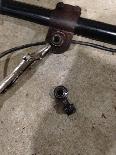

That seems to be the problem cause I tried to take off the end but it's not budging so I'm guessing it's welding on. It's a super jack 2 actuator that's at lease 20 years old

So this happened when I started messing with it when I got home from work. Guess it does screw off. Any ideas where to find a new one?

Scroll down a bit. You'd want this model, a little care, and it'll likely last the rest of your life. The ball screw model right below that is even better, but more expensive:
Venture MA-810-24K - $ 149.00
24" ACME Screw, 1000 lb Load, 32 Pulse, 10' Suggested mesh dish size.
