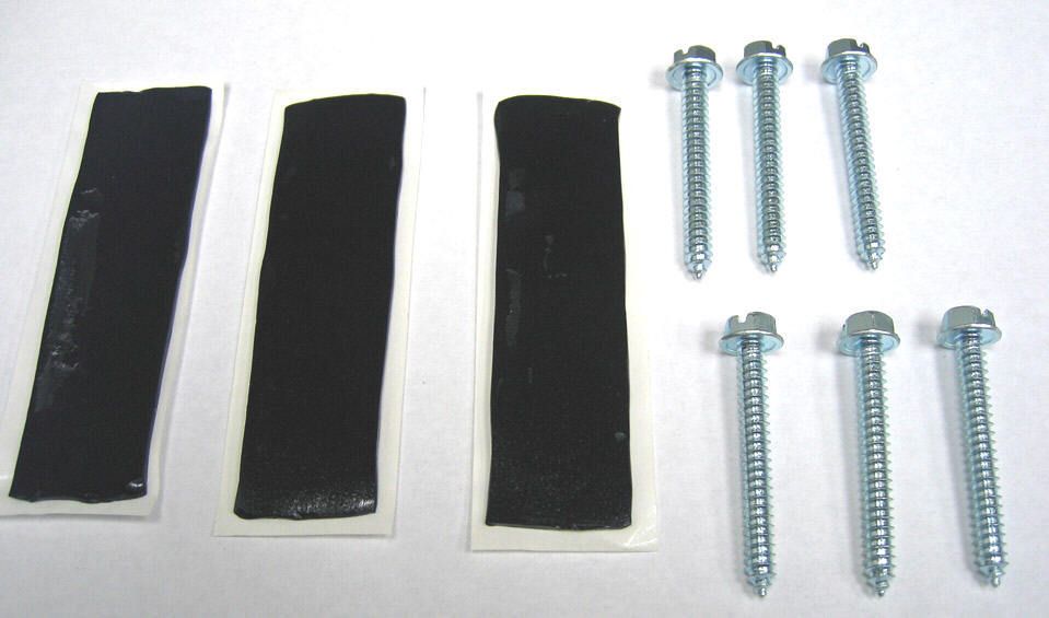

I use tar patches or pitch patches, to sealed the lags. Yeap, use this or roof cement is optimal.

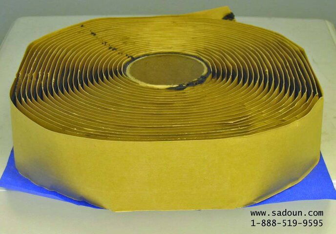

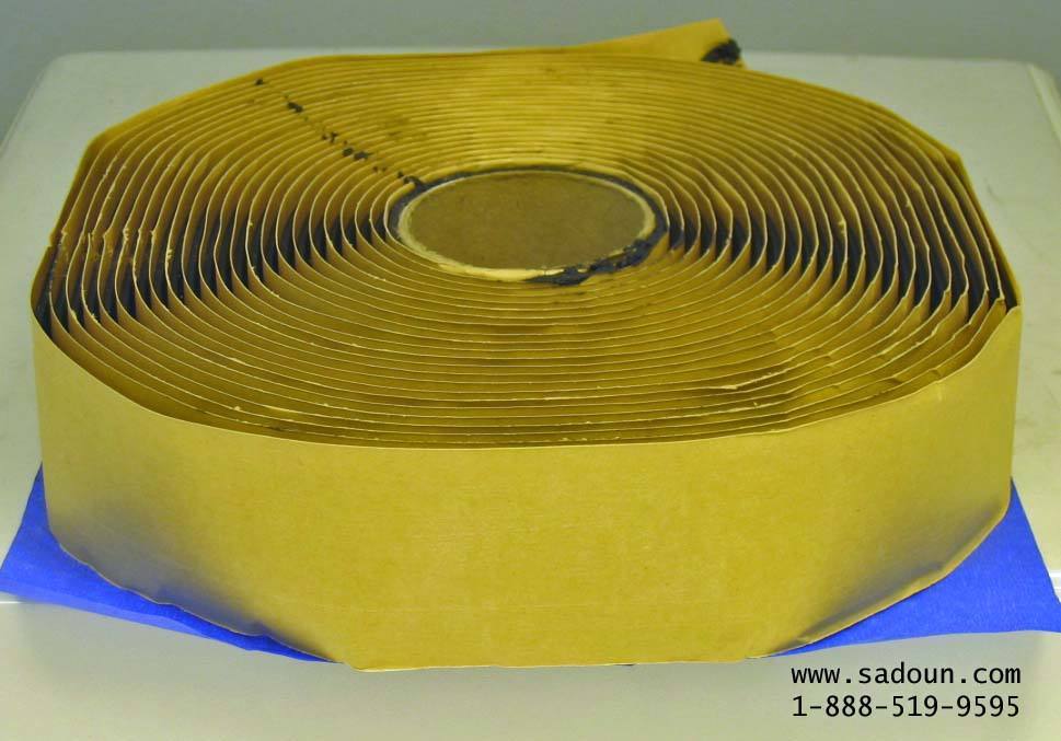

what you are saying is Bishop tape...
it is MANDATORY that every installer in Directv to use Bishop tape on roof mount. NOT silicone. we only use silcone to fill lag bolt holes if we are REMOVING the dish from the WALL. if it is on the roof and we're moving it, the base will stay but the mast will be removed.
every roof install gets bishop tape in my installs.
only time i will use a Sealant is at the top of the base so the water isnt gonna go under the mast in high wind rain down pour and will direct the water around or over the base of the mast so no water contacts the lag bolts and the bishop take will remain sealing the holes.
