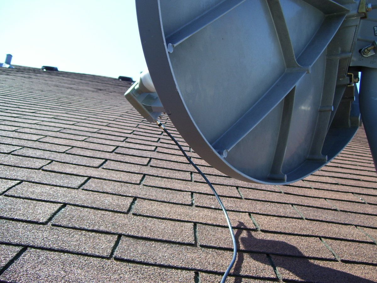

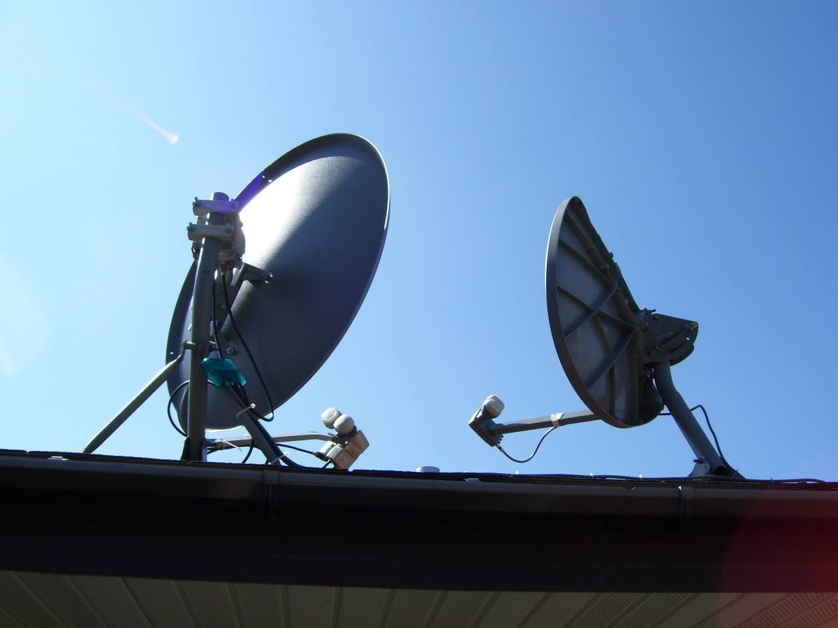

I can see to 30W here in Minneapolis which is a 9 elevation. I had to do some fabrication and just trial and error. If the mast is set properly at 90 degrees the dish hits it. So I had to spin the mast around and put it at an oddball angle to make it work.
IN the one pic its the dish on the right....the left one was aimed at 148W (when 148 was still alive) :(

By the way, what kind of dish is that with the support ribs in the back? It kind of looks like a channel master but then the mount is lower than center.

Its a Channelmaster 75e dish used for Shaw Direct (formerly Starchoice)...a Canadian DTH provider.
I use a 1.2m now because the LNB on that went out and it costs too much to get a replacement. Shaw Direct replaces the equipment for free if it dies but I have to be in Canada (which I'm not) ;)

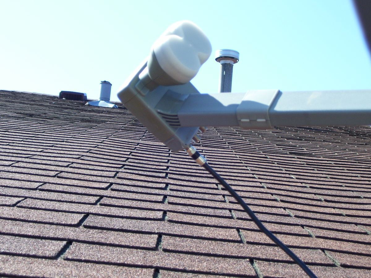

Its a really nice looking dish.. Does it have the same LNB/feedhorn setup as P* or does it have a DBS style LNBF?
Reason I'm asking is because the next project will probably be fixed DBS pay system to replace our basic cable. Still have to look around and see what company has the best deals.
actually neither
It uses a special "quad LNB" with 3.8 degree spacing (for 107.3 & 111.1 which are the 2 Starchoice sats). Its linear (like what FTA uses) Has a built in 22k switch. The 3.8 degree spacing can be hard to peak both as most sats are 4 degrees apart but I use to have it for 97/101 and later just fixed on 30W. Thread on the 97/101 setup
http://www.satelliteguys.us/545931-post8.html

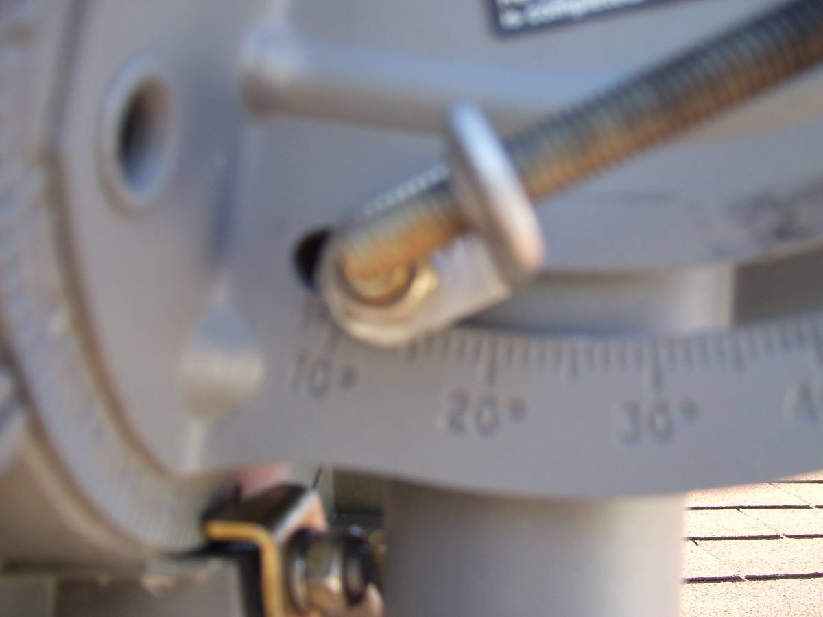

The threaded elevation bolt is just like a Primestar dish which makes it real nice. Dish measures 37x27"

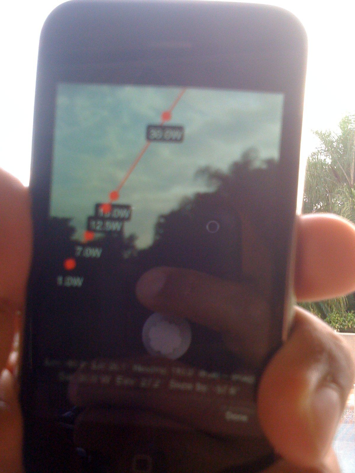

MikeLib..I was able to get Atlantic Bird1 using a 39in dish w/0.2 lnb linear. The sig on 11622H was S84 Q66 using a Coolsat 4000 with a short cable. My angle here in Ft Lauderdale is 13 degress just above some trees facing east of me. I was checking my satellite arc when I bought this house two months ago. I can get roughly reception from 12.5W to 135W.
Attached is a pic of my sat arc for lowest angles facing east. There is a neat application for Iphones that allow you to choose sats in a list, then hold it up to your location and it can show you your sat arc/obstructions, etc. I used my wife's phone to take a pic of my Iphone showing my arc. 12.5W just above some palm trees.
