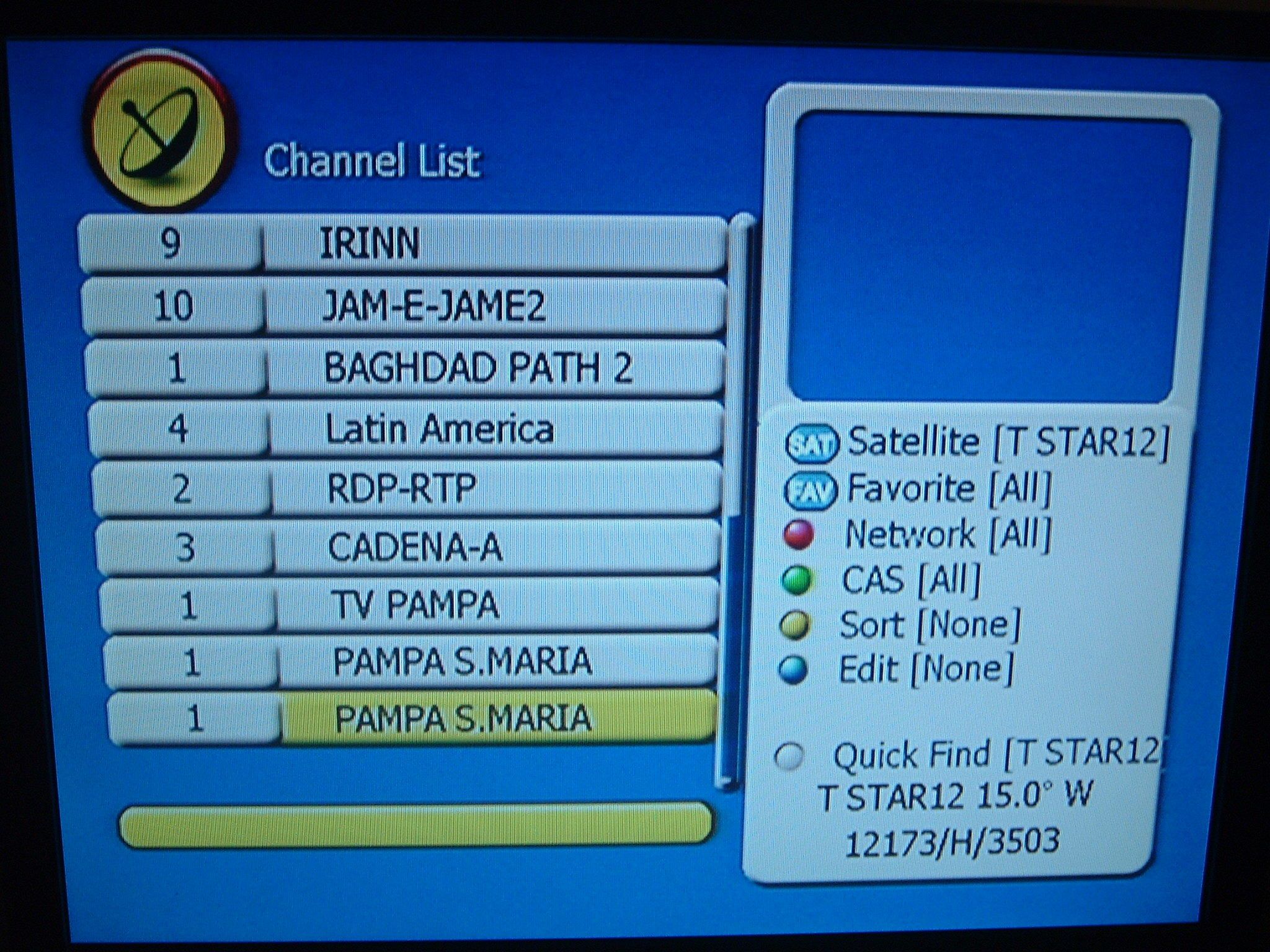

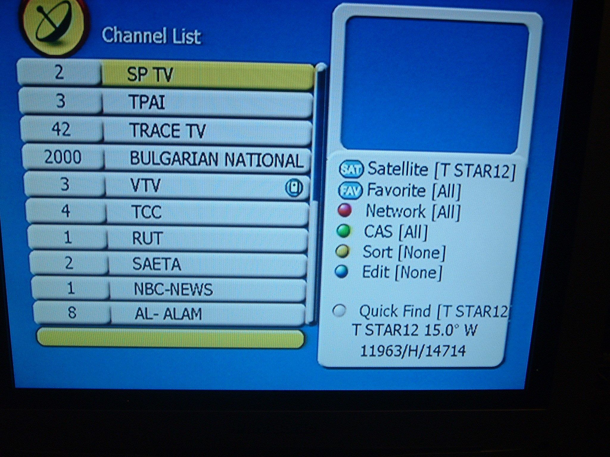

Here are pics from my receiver of Telstar 12, at the time I scanned in the channels TV Pampa was on two transponders.
