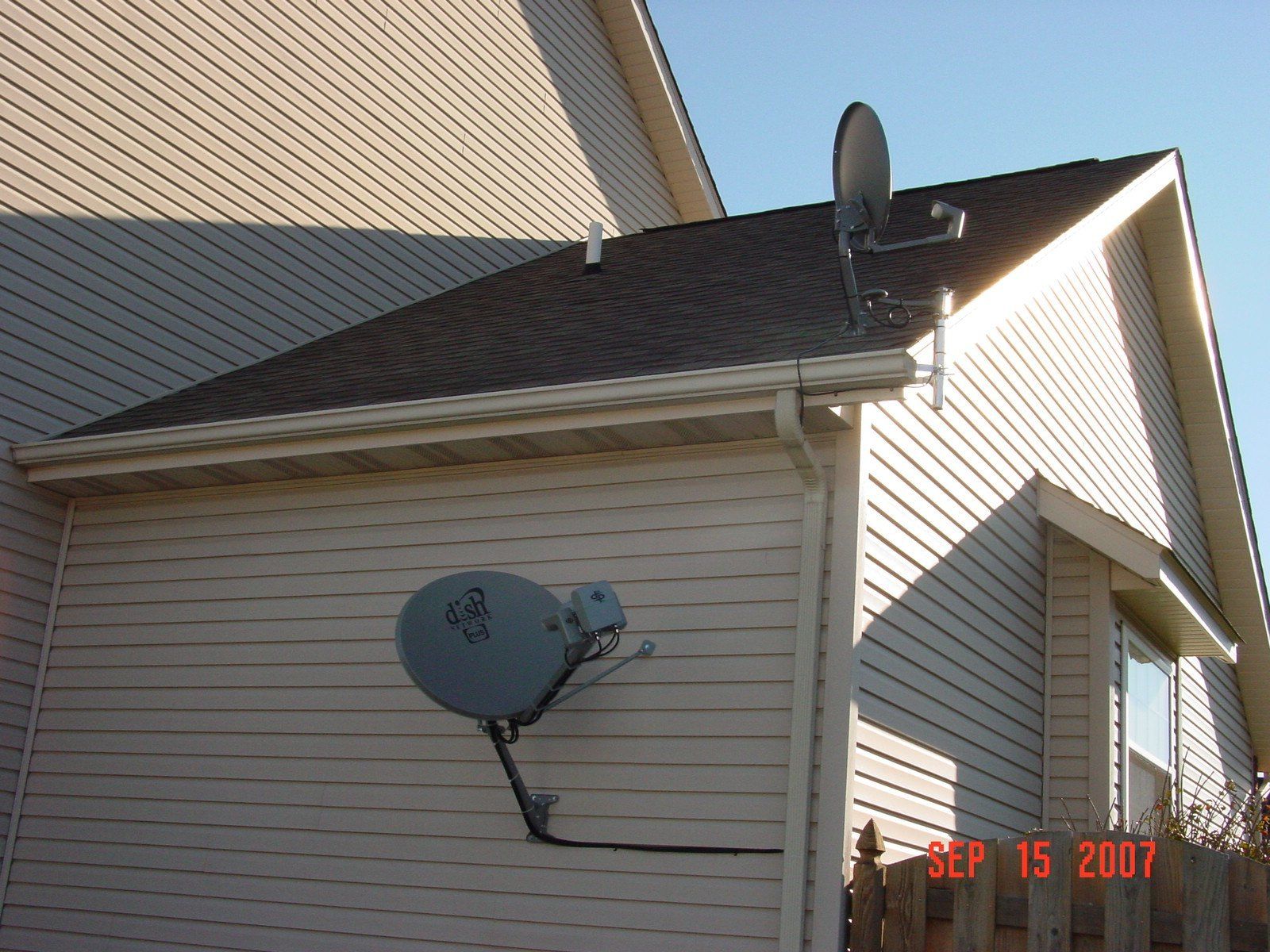

I have found that the roof is the most reliable place to put the dish. When mounted properly they don't move out of alignment. You don't have to worry about somebody messing with the dish, or accidently running into it with the lawnmower. Wall mounts stick out like a sore thumb, and with the use of vinyl you can't mount to that anyway.

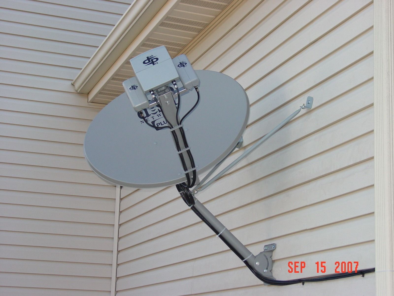

Sweet! Nice installation!Check this vinyl mount out. My retailer gave me the mount for a 1000+ before he ever came out for the install. I figured out exactly where it would go on the wall. Peeled up the vinyl and marked where the studs were. Under the bowed out air space of the vinyl installed 1/2 inch of OSD (I think it is called) where the mount lag bolts would be on the studs. The mount foot base center bolts are spot on center of the studs and so are the two support struts. It is mounted flush and no bowing in of the vinyl.
We can't mount to vinyl at all. The problem is that the dish locks the sidding in place. When it gets hot it can't move like it is supposed to. That is when it pops loose from the other rows. It will be 10 feet away from the dish and the vinyl is falling of the house.
The footing has 6 holes. Four corners and the two in the middle that are on the stud. I think I am not going to do anything and see what happens and then deal with it. Maybe it will be ok. What do you think?
