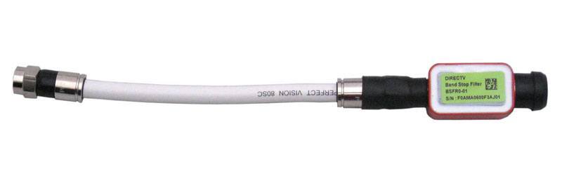

if your swm 8 way has a green labe you almost done all unused ports on splitter shout have a metal cap over them. on your two sd boxes you should have a filter on each one (also can be placed at the splitter depending on tech )
If all is set ( Green label filter show above, green label splitter , green label power supply/ if conectted to any hd box ) then all you will need to do is call like others have told you.
