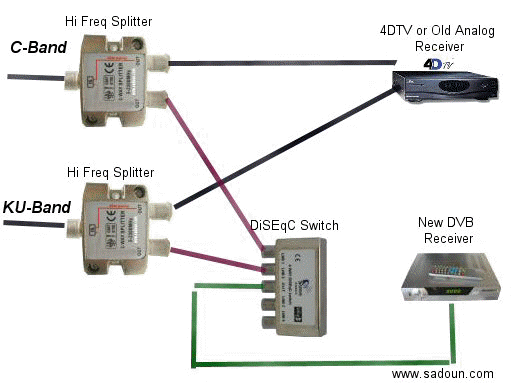

I have a general instrument receiver and I was wonder how to slave it to my sathawk receiver so I can move my bud
Bud-Slave-kit.gif Here is a diagram that should help. The splitters have one leg that passes voltage and one side that blocks it.
I'm thinking of just running c-band does that change the setup any
Or just run the LNB directly to the FTA. Use H polarity only with the FTA (18v to it then*). Control polarity with the analog. * some LNB's don't work that well with only 13vdc. Or use a power inserter???
