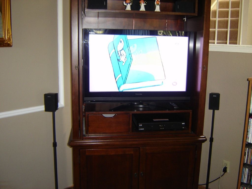

Randell, inside or outside of a cabinet ?
It's a cabinet but I don't close the door. Let me find a picture, I have it somewhere here with the 722.
Found it. BTW, the little speakers are long time gone. :D
